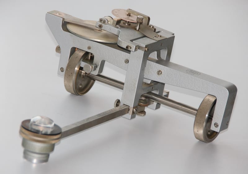

Anyway, I was given the job of designing these profiles, determining their section moduli as well as cross sectional area, profile perimeter and minimum included circle size (these last three numbers were used by our aluminum vendor when they quoted tooling costs and production costs). So for about a year I was doing this manually by making full-size hand-drawn profiles and then using a 'planimeter', a really cool little watch-like mechanism, to compute the area of the 2D profiles (but only if you were really careful tracing the profile of course):
Of course, even with that data I still needed to calculate the section modulus using transform coordinates.
