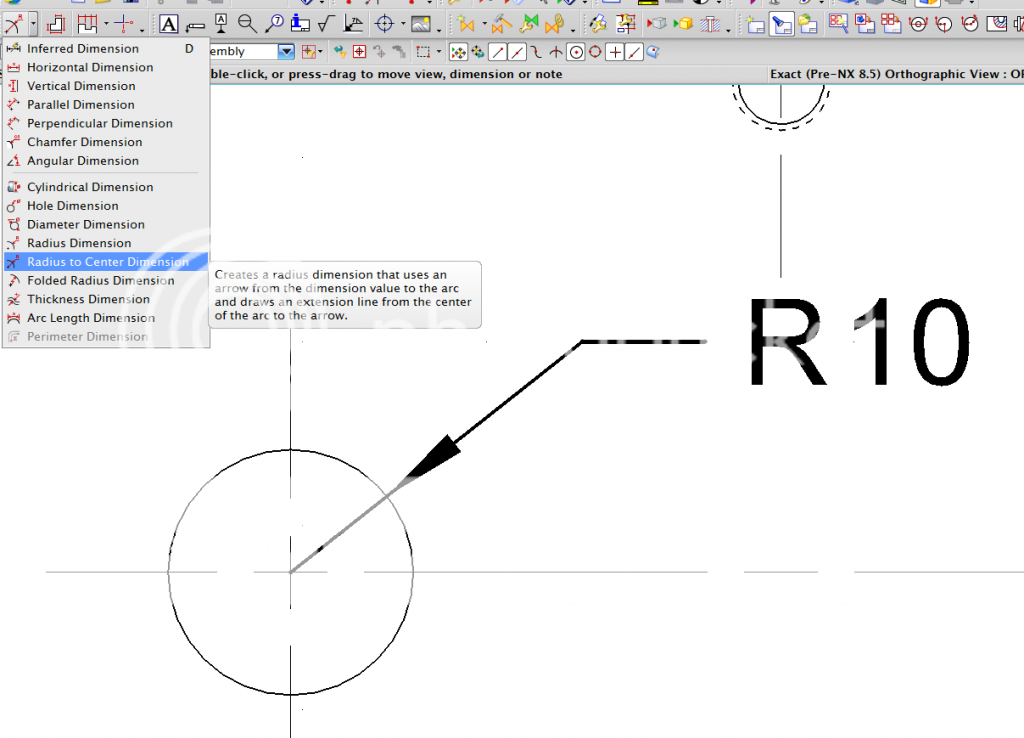

This is the first time I've ever had someone so arrogant as to cririze me for not having leader and dim arrowheads to point directly to the center of the circle from the outside. With that being siad, is there a way to get arrowheads to: 1)snap or attach to a circle and 2)point directly to the center of the circle. I've included a picture of what this "person" believes is wrong. Thanks for any direction given!
Using NX 7.5

Have you tried using the 'Radius to Center' dimension method:

JohnRBaker that would work as well, but I'd probably lose my job if that line were inside the circle. The workaround I've found I can use is the Hole Dimension and just edit the text. It works, but will be a pain if the hole size changes any, as it isn't associative anymore. Just wish that note with leaders could snap to the circle and point towards the center, but one can only dream......

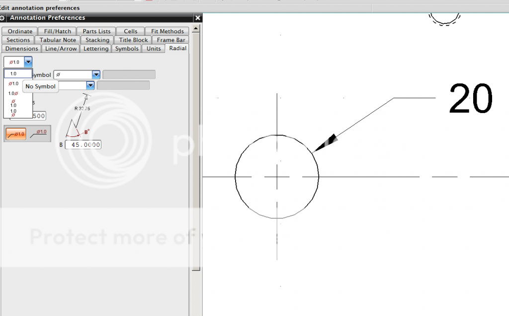

Why are you editing the text? Why not just set the...
Annotation -> Preference -> Radial
...to 'No Symbol':

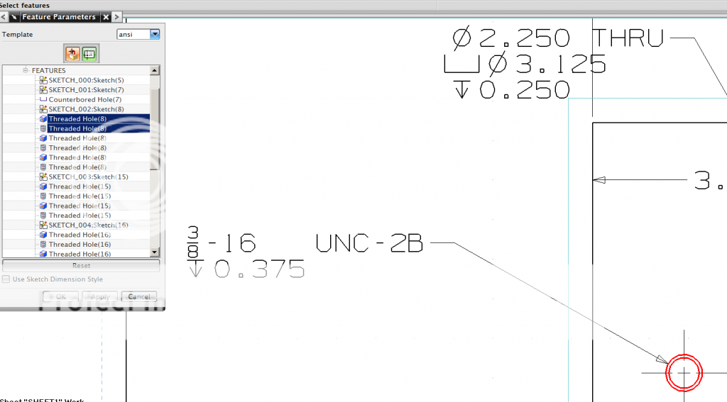

I think you will find that is you use...
Insert -> Dimension -> Feature Paratmeters...
...and select your 'Hole' features that they will automatically be created with the arrow pointing toward the center of the hole:

RE: leader arrowhead tpoint to center of circle
My features are not showing up in the dialog box.
How did you get your features to appear?
Are they real 'Hole' features or just subtracted cylinders?
They are threaded holes and simple holes.
Then you should have no problem using this approach. The dialog uses a 'navigator' like scheme so you will need to expand the 'tree' until you see the actual list of Hole feautures.

The problem is that the user is using a 'label' or Radius dimension when he should have been using a Hole dimension which DOES comply with the standard.
