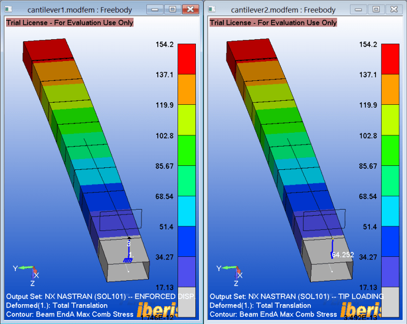

RE: Reaction Forces from enforced displacments
Dear Mechanik,
This is a very basic task, I suggest to contact your NX VAR or RESELLER to get CAE training in NX AdvSim & NX NASTRAN, this is critical.
Here you are a simply steel cantilever beam of 10x5 mm cross section and length 100 mm.
CANTILEVER1 (model left)
• One end fully constrained and at the other end a prescribed displacement of TZ=1 mm. Model solved and you get maximum beam stress = 154.2 MPa, and maximum displacement = 1mm.
• If I look to results I see reaction force at fixed node TZ=6.425229E+01. This should be the force loading to apply to the next model.

CANTILEVER2 (model right)
• One end fully constrained and the other an applied load FZ==6.425229E+01 N. Model solved and you get maximum beam stress = 154.2 MPa and maximum displacement = 1mm.
• Here you are the nastran input deck, simply import in NX AdvSim and you are done!:
Hello,
Thank you for the explanation.
Its been very useful.
Regards,
mechanik
