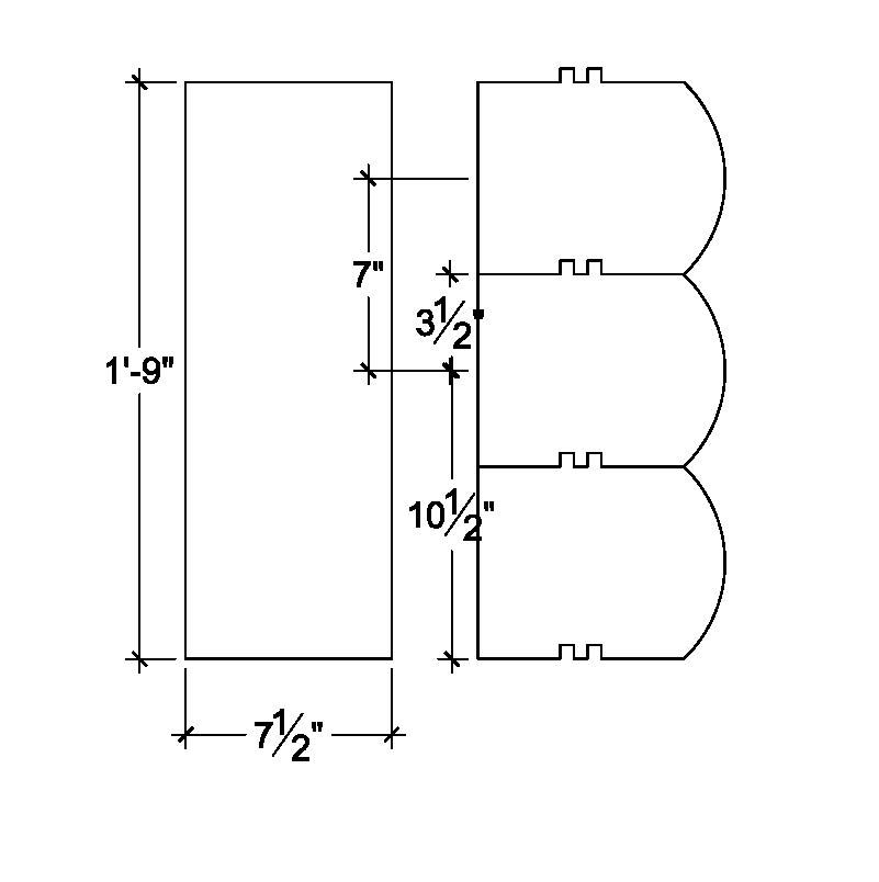

Ok I will start by disclosing that this is my first post. I been a member for a short while now. I looked in the other post before asking the following question.

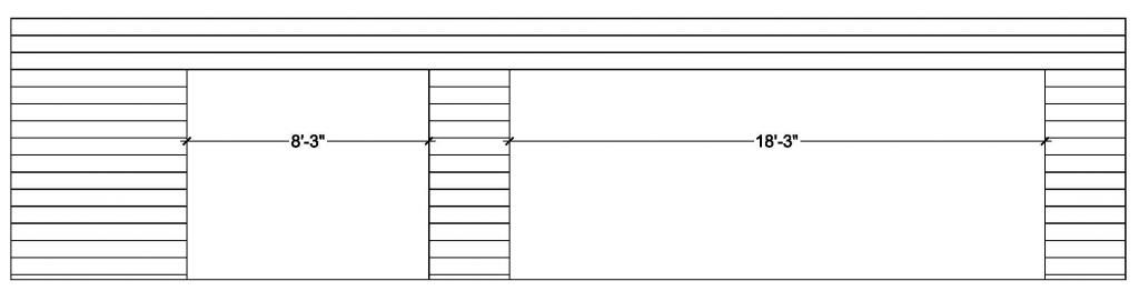

I have a friend that has come to me for some help. He is building a log home in CA and the logs that showed up on site are to short (16') to span the required (18.25') garage header. My first thought and analysis was to create a composite beam out of the three log lifts that will stack above the opening. I had planed on securing the three stacks together with through bolts or threaded rod at calculated spacings based on the simple span shear and the local horizontal shear per unit length at the connection of the outer stacked member. My only hang up with this analysis is am not clear if there is any structural disadvantage to not having a single one of the three stacked logs span the full opening length. As a composite beam, with logs butting end to end and stacked with the joints staggering, the header will span. Is there any thing I am missing with this analysis, do I need to include a hing at the location where the logs butt together over the opening?
Images Should be attached if I did it correctly. Thanks in advance.

This looks like a PanaBode log wall section. The header logs sections need to span as shown in the elevation and the supplier of the header logs needs to come up with logs of the proper length. Do not take chandes youself trying to save someone who has made a mistake here. By you getting involved, you will take the liability for the fix, not the person who made the error.

Thank you for your response. I believe a request for the proper length logs have been made to the manufacture but this request has been met with heavy resistance. Partially due to the case that the manufacture is have way across the country. I am just trying to come up with a alternative solution for the owner/builder. I have come up with two possible remedies to the short log lengths. The first is that presented above, which utilizes already purchased materials. The second is to design the header using a glue-lam and face the header with a fascia from the short logs. I would like to exhaust the first before recommending the second. Oh and the logs are a classic 8x8 "D" shape similar to PanaBode.

I don't think there is a way to make the current wood work (remedy one) that is easier than facing a lvl or glu-lam beam (remedy two).
Honestly if this is a pre-manufactured building then who cares about resistance, they either provide the proper materials, or engineer a solution themselves and get their engineer to sign off on it.
If you cannot get the proper length pieces then remedy two is definitely the way to go over coming up with some way of load transfer using bolts without a continuous member.

You do not want to see a vertical butt seam in the wall. The use of a glulam is ok for the space, but you would have to face it with cut logs to get the same look, and would still have the vertical butt seams since you do not have full length logs.
Just push the issue and wait for the longer sticks. You will be happier in the long run.

GlueLams are made under pretty rigorous shop control, and they won’t usually have butt joints in the outer couple plys in regions of max. normal bending stress, or max. shear. The outer couple plys will also usually be of a better tensile grade than the inner plys. Many times the butt joints are finger jointed, and seldom (never) fail at that finger joint. And, you just can’t duplicate this quality control, grading and gluing with the logs, out in the field. Otherwise your thinking about GlueLams is about right, most good wood design text books cover the theory behind their manufacturing and use. Through bolts alone won’t work will, because they have to move too much in their holes before they really come into bearing on the holes; meaning much slip in the two horiz. joints and much deflection of the header. And, the bolts will loosen as the logs shrink. I think your best bet would be the GlueLam for the header, and rip some slabs to cover the outside face. It can be an industrial grade GlueLam, rather than an Arch. appearance grade. I can imagine several ways your three log header might work, but they are probably more work than they are worth.

You might make that header 32 or 34' long (maybe longer, and embedded in the wall) to go over both openings, at once. And, you might need some moment frames (moment capacity, for lateral loads, EQ, etc.) at the two outer jambs and at that 3'-6" center jamb.

The contract plans for this structure as some of the most lacking I have yet to see. The plans and permit for this structure were done in 2008 and lack in my opinion lots of information that a good builder would need. There was some miscommunication between the structure designer and the log manufacture (not the same entity). The log manufacture only mills "D" logs in 14' and 18" lengths. Designed clear opening was 18.25' oops...
cvg
I do not wish to redesign any structure. I am merely trying to be a resource. as it stands of now, the owner/builder is contacting the manufacture of the logs, (structure designer has since past away, making things more complicated) to have them supply a design for a full length header beam over the opening. He is also pushing them to cover the cost of the beam and delivery fee. We shall see how this will pan out. I am interested to see how they come up with a positive attachment to the log walls, I would assume a vertically bolted connection at each end with a horizontal strap on top of the header. We shall see.
