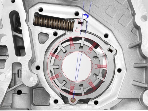

The points made above regarding the importance of oil mass flow to specific components in the engine are excellent. The cooling provided by engine oil is just as critical as the lubrication it provides. With heat transfer from bearings/journals to the lube oil, it's the oil mass flow that matters rather than simply the oil circuit pressure.
The comments about the insignificant impact of oil pump drive losses are partially correct. For example, with a typical positive displacement engine oil pressure pump flowing 25gpm, lowering the discharge pressure from 80psig to 40psig would reduce the power consumed by the pump by less than 1hp. For a 500hp race engine that operates most of the time at WOT, this 1hp difference is not really significant. But for a small displacement production auto engine that operates much of the time at part throttle conditions while producing something like 20hp, that same 1hp difference could impact fuel economy by several percent. A 3 or 4 percent impact on the highway fuel economy of current production autos would be of great concern.
One issue with the typical positive displacement oil pumps used on engines is that they produce a fixed output volume per revolution and are driven at a fixed ratio of crank rpm. Since they must be sized to provide adequate oil flow at low rpm, their output at higher rpm is excessive. In order to prevent oil circuit pressures high enough to cause damage to filters, cooler cores, etc. the excess oil flow at high rpm is bypassed, which results in power losses. To address this problem many auto OEMs have begun using variable volume pump designs.

Tbuelna, thanks for the picture. That's a fascinatingly clever pump design, which I had not seen before. 25 gpm oil flow in a car engine seems really high. Is that a realistic number?

That 25gpm number was just for discussion purposes. As others noted above, engine oil flow is mostly based on cooling requirements. A rough estimate of the cooling provided by a 25gpm oil flow would be around 83hp, assuming a temp rise of 30degF, an oil density of 7.2 lbs/gal, and an oil specific heat of 0.65 Btu/lb-degF. 83hp (62kW) is definitely a lot of oil cooling capacity for most auto engines, but maybe not so for a 700hp race engine operating at WOT.
