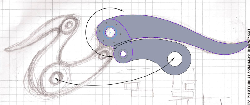

Hello everyone.
I have a model with very curved profile shapes (in Y axis (plan view)) I have a series of half lap style hinges that won't allow an angle limit. Is it my curvy shapes? I have no flat surfaces(faces) to use as angle selections.
I've created 2 of the five parts needed but I'm having a hard time with the next parts as i need rotational limits within Solidworks to create the appropriate clearances at each end of the part's swing.
Any ideas how to correct the problem? Maybe a work around?

Create a reference plane in each part along the axis of rotation. Use those to set your angle limits.

I tried that but the planes don't show in the assembly. I must have something set wrong if I should be able to use reference planes..
RE: Hinge Mate problem
You can expand the parts in the tree to select the planes directly or adjust your visibility settings so that you can select them for mating.
Check your View menu and make sure Planes is turned on.

As for my problem,I turned on the planes (thanks) I think the planes have to be on th same arch so I'll probably have to get a common center line in there.
Thanks for the help
