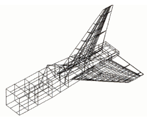

I am writing to ask if anyone has any experience with buckling analysis considering inertia relief effects.
I ran some tests with small models to check if buckling modes considering inertia relief effects or SPC approach with fictional body loads should give the same result. It was OK for small models (except for the ones containing angular velocity).
But, for a more complex model of an aircraft in flight (considering pressure loads, linear accelerations, angular accelerations and angular velocities), buckling modes get strange (ones are like rigid body motion, but not 6 modes).
I don't know if angular velocities have any effect on buckling/inertia relief calculations.
I am using MSC Nastran v 70.7. Any help is appreciated.

"I don't know if angular velocities have any effect on buckling/inertia relief calculations."
I can imagine cases where it certainly would - e.g. angular velocity puts parts of the structure into tension, thereby changing the buckling load factor / mode shape for that element. (Your solver may even find a negative buckling load factor for an element which is in tension.)

true enough, but usually we're solving loads at a point in time.
are we talking about a wing structure ? a wire braced bi-plane ?? a heavy shell structure ? a fuselage ??

@jhardy: That's true. I tried removing angular velocities and mode shapes are still weird (first 4 ones like rigid body). Looks like the solver can't split rigid bode modes from real buckling modes.
@rb1957: We are talking about a complete but simplified aircraft model. It is a composite glider. I will show you a picture of the model to give an idea. Please see the picture below.
I am still trying to solve this problem, but I'm a little bit stuck now.
RE: Buckling Analysis With Inertia Relief
see i think that answers julian's concern (re structure stiffening due to velocities) ... ie IMO it doesn't.
determine all the accelerations on the a/c (glider) ... linear velocities shouldn't affect the results, rotational ones develop linear accelerations that you need to apply. maybe your FEA can tell you when something buckles, maybe your structure (stiff shells/skins, as opposed to thin Al skins) allows this (with thin Al skins you have to analyze for shear/compression buckling, ie diagonal tension).

Hi people,
I am here to inform that today I had good progress with this calculation.
I noticed that 2 major points are pretty important:
1-The correct specification of the SUPORT entry;
2-The request only for positive eigenvalues. For negative ones maybe some matrix turns ill-conditioned. (makes sense in my load case).
I will try more tests tomorrow with PARAM,INREL,-2 (software should specify the best support point). Let's see what happens.
