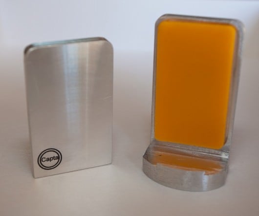

I am looking for a reusable sticky adhesive that'll stick to plastics, metal, glass etc. I unfortunately am not that into chemistry and don't really know what to do to find this material. I can't seem to find a company that advertises online that it makes the stuff, or find anyone who has a formula for it. From what I understand it's simply soft TPU or TPR that hasn't hardened enough, is that right?
I'm looking for pads on the line of Clingo, UDS Capta etc I have the UDS version, it's ok but it's thick and isn't that tacky at first, it takes a while to become better.

i know that stuff, they sell it at crafts stores, it's not the same thing really. I'll share some photos of what I'm talking about...
Need something that I can permanently attach to my product...
I believe it's plastisized polyurethane, something that hasn't hardened, they are all gel like.

Yes, it is a plasticized polyurethane. Looks a lot like Sorbothane (TM).

Here's what Baymaterials had to say...
The type of polymer you are talking about is generally a very soft polyurethane or polyolefin. (TPU or TPO). In order to be soft enough to be an adhesive it is generally necessary to take the base polymer and "oil extend" it by adding a compatible fluid.
