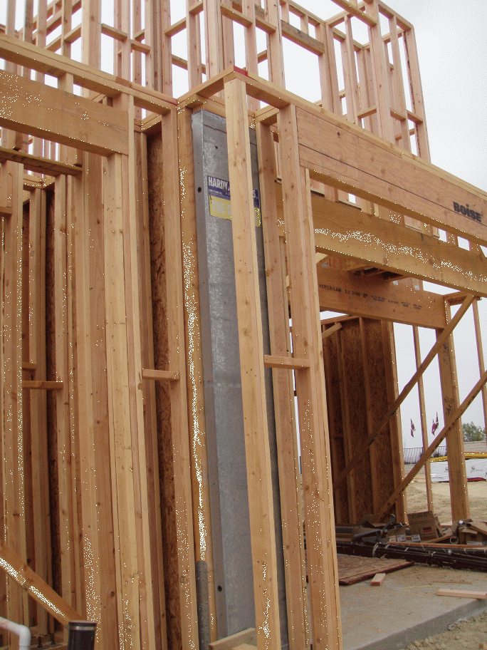

I am in the middle of a disagreement with my structural engineer. For a 18 feet by 8.5 feet door opening, my structural engineer instructs me to frame it just like a 2 feet wide window except a bigger header on double studs. I think it's wrong, but I don't know what to show him. Can anyone point me anything to prove he is wrong?

Garage doors are horizontally spanning structural elements. When the wind blows on them, the load is transferred to the king studs which transfer the load to the foundation and floor or roof framing above. The jack studs typically are only counted on to support the gravity (vertical) loads. As such, more king studs are required on a wide garage door than a narrow window. Don't know if wind is a problem for you in California. For seismic, it probably does not make much difference as a garage door is so light.

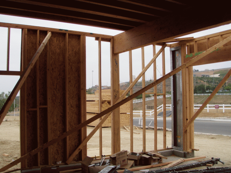

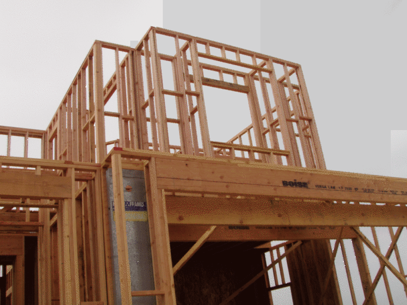

Not running any loads on this thing so bear that in mind. But I would be more concerned that there are only two full height studs adjacent to the garage door. I see that you have metal panel shear walls. So you are probably either in a earthquake zone or a high wind area. Whether the cripple studs are adequate or not really just depends on how much axial load they are carrying. But in my mind only two full height studs probably isn't enough for the out of plan wind loads that the garage door will be transfering on to them. However I don't even know what wind zone you are in and unfortuneately this is an all too commone problem with stick framing around the garage door area. Side entry garages also have a lot of advantages by getting rid of the need for the those short shear panel return walls.

Although the header is at the very top, I am only seeing a single full height stud carrying any out-of-plane loading. I would check that stud for the point load. Also, I would question the toe nail connection of the single jamb stud delivering that wind load to the top plate.
