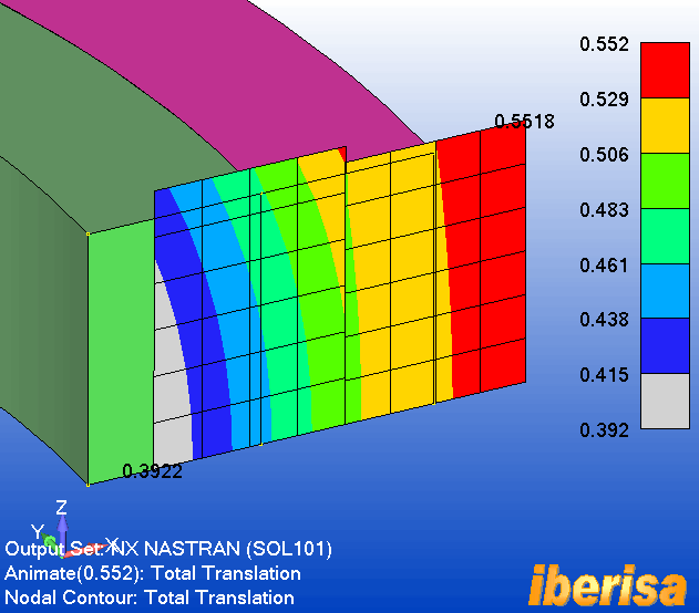

I understand you are running NX Advanced Simulation, not FEMAP, in this case the option choosed of "ANALYSIS TYPE = AXISYMMETRIC STRUCTURAL" is mandatory, you say that you want to run a Axisymmetric analysis (solid of revolution) where the study of 1-radian is perfect as both loads & geometry repeats constantly in 360º, then the finite elements available are 2-D Solid TRI/QUAD elements.
Here you are a 2-D axisymmetric analysis with contacts:
In NX AdvSim the workaround is to study say 1/4 model, prescribing the symmetry boundary conditions in the planes of symmetry. Here you are the same problem in 3-D, results are exactly the same, but you pay the tickect of solution time & model size:
Using FEMAP you are free to mix 1-D elemets with 3-D or 2-D elements, not limitation, .....
