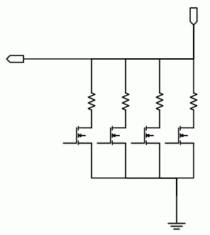

I've got a regulator that controls to a specific operating point via current thru a resistor.
I want to be able to select between a couple of resistors to set, say, three operating points. My problem is that the resistors will have between 300mA and 1500mA running thru them and are somewhere around 0.1 ohms to 0.5ohms.
Digital pots are out cuz they don't do amps.
So I thought of using MOSFETs switching in resistors or perhaps shunting them. There are lots out there with sub 0.0x ohms ON resistance. But I'm thinking they'll be a problem since they all have fairly large thermal drifts. Just the thing to have around a thermally active regulator.. All their charts also seem to peter-out down around 1A so I'm not sure what happens when I'm only pushing 300mA thru them. The controller point looks to keep the top of the resistor at about 300mV which again isn't much of a source/drain voltage. Again that's off the charts.
Got any suggestions?

Are the set point resistors floating? If so, then the only practical option is a relay. If one end of the resistors is returned to either the positive or negative supply rail, then you can use a P or N type switch (MOSFET *or* bipolar) to select the resistor and simply read the voltage drop across the resistor alone, rather than the series combination of resistor and switch, to sidestep the issue with drift in channel resistance or saturation voltage.

Hi Magic. (Had a Boa Constrictor named that.) The resistors are indeed ground referenced. Small mercies. So this all happens around 300mV from ground. I'm not following.. OH! Wait I see you're saying put the switch above(electrically) the sensing resistor so it's resistance/voltage drop is unmeasured. I love it! Thanks. This is exactly why I came to you guys. Get stuck in one mindset and miss the best solution.

Naw. Though the thought crossed my mind. I'm looking at maybe ten of these per unit. So curve tracing or characterizing individual switches.. no thanks. :) Not to mention the pwm the resistor will be subject to. Yikes.

True. And now with the actual resistance and voltage drop of the "switch" not being a part of the sense voltage the transistor needs only support the maximum expected current and be fully ON at logic levels. These will be set-an-forget so the switching speed, gate capacitance, etc., don't matter. Since the voltage above the resistor never exceeds 300mV the transistor doesn't even need any Vds ability. Schweet.

I don't see how MagicSmoker's idea is going to pan out now. Notice in B I can't get the paralleled voltage drop out to the regulator without getting the filthy transistors into the picture? Like picking off the return in A above the transistors.
Sounds like I'm back to Opera's idea.

I think you need to have the transistors and resistors swapped. I was imagining a single tie point with N resistors with their own pulldowns. So long as only one transistor is turned on, and turned on hard, only one resistor is sinking the current, and the control system is simply sensing between the tie point and ground. The only thing that you would need to do is to make sure that the control system has the correct gain term. Am I missing something here?

Re the sense circuit. Use one resistor from top of R23, R21, R24 and let them land in a summing point (-ve of an opamp). Let R21 be your highest value resistor 500 mohms) and make the other resistors have values so that you get 0.3 ohms (my guess) and 0.1 ohms total resistance when switching Q4 and Q5.
The active path's voltage drops will add and those that do not carry current add zilch (resistor grounded).
You could, of course, also use a non-inverting opamp, but the math is somewhat less trasparant (the 1 added to Rb/Ra). And, finally - you can use same value resistors for R21 etcetera and use different values for the sense resistors.

That would seem to be a matter of picking the right transistor. Keith's OP stated 0.1 to 0.5 ohms, so something like this:
http://ec.irf.com/v6/en/US/adirect/ir?cmd=catProdu... would be possibly even a bit of an overkill. The spec Rds is less than 1 milliohm with 61 A Ids.
There are lots of choices if a larger error is tolerable:
http://ec.irf.com/v6/en/US/adirect/ir;jsessionid=F...
http://www.irf.com/product-info/datasheets/data/ir... appears to be cheapest at $0.513 in 1000 qty and has less than 10 milliohm Rds. It looks like Rds will be limited by the non-channel fixed resistance portions of the circuit, as would be the case with the current sensing resistor connections.

Hi IR: I'm still struggling with the vagaries of transistors. The sense resistors are 0.5 ohms down to about 0.1 ohms. While the 1 milliohm might work the 2 bucks sure won't when multiplied by 15! That's adding $30 to the product cost. The cheaper ones you found end up having about a 10% contribution of error. If I could mess around with the resistor values to cancel them out we still have the temp coefficient rearing it's head. That will bring a 25% change in the Rds over this thing's operating temp.
Skogs.. I've used one of those 545As! CLICK CLICK CLICK. I understand your need.
So "C" is where you're going here? The switches are again outside of the sensing scheme.. I get it. I think it would probably work as long as the incurred delays don't destabilize the whole control loop.
But. If I'm bringing in op-amps maybe I should just dump the switches and use a $0.30 digital pot to pick up 64 different settings.. "D" The digital pots come in at less than transistors of the type contemplated...

OK, so you could use one resistor for the whole current range?
Then I don't see why you should work on the measurement (actual value) side at all. It is a lot more convenient and reliable to vary the reference value aka setpoint. Then you don't have to worry about differing dynamics and stability at different settings.

Since you only have a single pot in "D", the summing amp is not necessary, and you could use a single non-inverting op amp and cut the op amp cost in half. In fact, have two op amps may work against you, since the op amp offset will show up as an error in the current sensing. Something like http://www.ti.com/product/op07c might be a good place to start.
As for temperature effects, even the sensing resistor itself would be problematic, as would the offset voltages and currents of the amplifiers. In some respect, the transistor switch may actually be better, since the transistor will be in hard saturation, and the channel resistance is even in the picture. You'll be dominated by the diffusion and metallization resistances, which would be similar for any possible alternative. The thermal compensation is something that would have to be built into the controller itself. Or, you might need to build something like a Wheatstone bridge to eliminate the sensing resistor changing vs. temperature.

You're right IR. A single SOT23 should do the trick nicely. I've found fast ones for 50 cents. Some even come with digital gain adjust for a few shekels more.
Great. Thanks guys. I think I've got it now. :)
