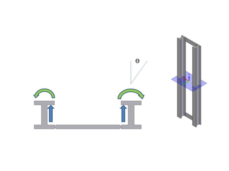

I'm looking to figure out a way to determine how often a welded tie bar is needed within a given length of I-beam. There will be a tie bar at each end and a force will be pushing on the flange of the beam (blue arrows) at the blue plane. This will cause the beam to want to peel out relative to each other an angle of theta, thus causing the tie bar to bend as well. I'm looking for a way to have an equation in which you input the desired angle, length and thickness of the tie bars, and height of the top and bottom tie bar, and it will output a location and height of the required intermediate tie bar. Any thoughts or a point in the right direction is appreciated.

The beams will be fixed at one end and all I am trying for is theoretical, there will be a factor of safety implemented.
I am thinking of cutting the section in half at the blue plan and treating it with a torsional load on a cantilever beam. The part I am unsure of is how to include the tie bar into the calculations for the torsional rigidity of the beams.

Assume the beams are sitting on the ground for the vertical constraint.
The green arrows in the picture below depict the horizontal constraint in both directions.
The forces are shown in blue are also applied on the hidden side of the other beam. They are equal per couple however are not necessarily equal per rail (the 2 blue arrows in the first picture are unequal). The forces are free to slide the length of the beam.

Alright, going to basically start over at this point.
Application-Forklift mast
Problem- When all stages extended, carriage or one section of mast pulling roller out of the mast by twisting the beam. The carriage twists when there is unequal loading on the forks or the fork truck is on an uneven surface, or a combination of both. Tie bars are then used between rail sections to stiffen rails from bending or twisting thus allowing the carriage to work its way out.
The carriage applies the load through load rollers and force on the rail is shown in blue.
The mast is constrained at the green arrows.
Currently tie bars are determined by a long history of what has worked and what has not. We are looking to create an excel sheet for new designs along with updating old, where we fill in all of the variables and it spits out size, location of a tie bar or two or three if necessary, instead of guess and check with fea.
All the variables are as follows:
a-bottom tie bar distance from bottom
b-middle tie bar distance from bottom
c-top and bottom tie bar height
d-middle tie bar height
e-rail spread-edge of k to edge of k
g-load roller height from bottom
h-rail depth
k-rail width
L-rail length
n-web width
m-flange width
r-carriage retention-distance between load rollers
t-tie bar length
x-mast retention-distance between roller of one stage and the next
There is no problem specifically, I would like to solve the equations with the use of variables.

My gut tells me it would make sense to test various arrangements, and use the test data in a spreadsheet. Probably cheaper than doing all that analysis.

The biggest problem in talking with the experienced engineers who developed the original designers is that they don’t exist, at least not at our company. We started out as simply a manufacturing facility, building oem products and slowly over the years have acquired designs from companies we purchased them from. Recently we have found a niche in custom masts and carriages. Over time we have figured out every main aspect of the mast and carriage design except tie bar location and size. We have a fairly young design team, majority under 30, everyone under 35, so the experience is lacking some.
I know an excel sheet is a bit of a dream but ones allowed to dram right? Our boss wants us to try to figure out something using hand calculations and verifying them with fea, to exercise our brains, even if the hand calculations are crude at best.
That gets me back to my original post, trying to keep it simple enough to do by hand, but complicated enough to be useful. I went with two cantilever beams fixed at one end, tie bar at the other, and using torsional equations for a beam. I am stuck with trying to figure out how to work the tie bars into the equations.
The mast in the picture is ours I believe; however we don’t do anything with truck design. I will try to dig up some larger masts to show how they are attached, and get some dimensions and loads for perspective.
As far as adding in retaining devices ,that is something that we do on our heavier, more expensive masts, but it’s hard to justify another $1000 on something that costs $8000 when is seems like everything today is sadly cost driven, not quality driven.
If you have any input or anymore guidance that would be greatly appreciated.

You have two I-sections and the question is regarding the spacing for the tie bars between the flanges, correct?
I would suggest that you study the problem one section at a time. Calculate the section properties for bending and torsion. Set up equations for equilibrium and stability with the proper boundary conditions. Unfortunately the boundary conditions will probably be springs but that is reality. You may or may not find some possible simplification along the way.
You can compare it to a finite element approach but you do it "by hand" or by Excel sheet. Do one element, then the next, the assemble.
As for the tie bars, I think they will primarily contribute to the torsion of the single beam. As I understand it the forces does not have to be equal between the beams. Unfortunate, because symmetry would help.
A different approach would be to set up a parametric model in some kind of software. But that was not the question as I understood it.
