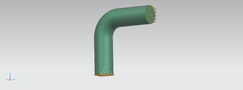

So I'm trying to learn to do some basic CFD analysis using NX 7.0, specifically on internal flow in a test model of a 90 degree angled pipe. My process is as follows:
  1. I open my part, pipe_test.prt
  2. Open advanced simulation environment
  3. Right click part in Simulation navigator and select "New FEM and simulation"
  4. Use standard parameters, I just change run directory in solve options to "Simulation-solution name" from "current simulation"
  5. Afterwards I go into the idealized file, and use Wave Geometry Linker, I then open up modelling environment and create the area of the internal pipe with Synchronous modelling and delete face. (I delete everything but internal faces and thus create a model of the flow area)
  6. I go back into Advanced Simulation environment, and enter the FEM file. I then suppress the body of the pipe, and am left with the body of internal flow area.
  7. I add a Tetrahedal Mesh (Tet10) with 5mm element size, and add water as material directly through the mesh collector option.
  8. I then go into the SIM file, and add two flow boundary conditions. Inlet flow (3000mm/s) through one face, and an opening condition through the other face. Illustrated with this picture
  9. I right-click solution 1 and hit solve. That's when I get the error messaged which I attached.

RE: Error message in basic Flow Simulation [CFD analysis] NX7
Dear Lars,
Your mesh "3d_mesh(1)" is located in folder "Solid(2)", that is empty of properties, then the error. Simply "Drag & Drop" "3d_mesh(1)" in folder "Solid(1)" and you are done!.
Using the K-EPSILON turbulence model the CFD analysis solved in 18 iterations (less than 1 minute!!):
