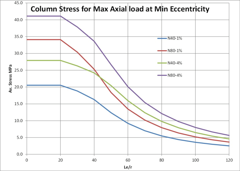

If you look in this thread I posted a graph of what I believe the decrease in strength should look like with increasing Le/r thread507-325661: preliminary design of columns.
I think the wall provisions He^2/(2500*tw) underestimates this. And a member such as 720x180 in my opinion needs to be designed as a column based on the dimensions alone.

I work on infrastructure projects (using AS 5100 or AS 3600) and I'm not familiar with standard practice in the building area. I always use the column provisions for any member with significant axial load, but this thread led me to look at the wall provisions more closely, and this is what I found.
  • For the column/wall given in the OP, assuming pinned connections top and bottom, minimum eccentricity, 100% dead load, and M*1/M*2 ratio of -1, I get a column capacity(phi.Nu) of 1461 kN and wall capacity of 1489 kN. (1% reinforcement in the column, 0.15% in the wall)
  • Applying the same method used by asixth in his last post, I get the stresses at maximum design load shown in the attached graph. For low slenderness ratios the column has a substantially higher design load, but for high slenderness the wall has a much higher design load. Given the lower reinforcement requirement, this doesn't make sense.
  • I can find nothing in the code to indicate that the wall provisions are not applicable in this case, of for any wall with an effective height/thickness ratio less than or equal to 30, and low eccentricity applied load.
In summary, either the column provisions are over-conservative, or the wall provisions are dangerously un-conservative (or both). Either way, a revision of the code seems to be necessary. I will continue to use the column rules, but if presented with a column similar to the one described in the OP, designed to the wall provisions, assuming fire requirements were not applicable, I can't see any way in which it would be outside the code requirements.

There was an error in my previous post. The column capacity should be 1320 kN. The linked graph is now corrected.

Prompted by this thread, I have added a MaxAx() function to my RC Design Functions spreadsheet, which will calculate the moment magnification factor for a specified effective length and axial load, or the maximum axial load for a specified effective length and eccentricity.
More details and download at:
http://newtonexcelbach.wordpress.com/2013/07/21/us...
I have regenerated asixth's chart using this function:
I get slightly higher stresses for Le/r, maybe because of 500 MPa steel, or possibly some other difference in assumptions.
