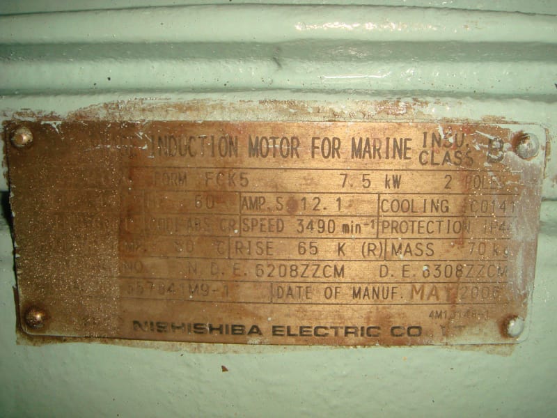

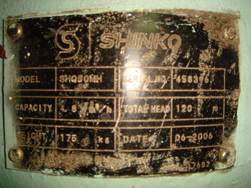

RE: Overload problem happened on boiler feed water pump
To dear LittleInch and dear ScottyUK:
Thank you for your hospital help and generous teaching, It is my fortune to have it.
First photo is the pump motor, it was badly worn on the very left part, and I am hoping this could still provide any useful information.
Second photo is pump's name plate, kindly for your reference.
The power (measured by VFD) when pressure-controlled valve closed (shutoff head) is 5.45KW, current is 10.7A
The power (measured by VFD) when pressure-controlled valve opened is 11.49KW, current is 17.8A.
The VFD is a retro fit, which I want to decrease the frequency in order to match the actual head & flow for better performance and solve the overload problem.
Thank you for your kind instruction and help, sincerely thank you and with my best regards.
And please ask any information I missed to mention, thank you in advance.
Salvation, I thought you had gone on holiday...
below link is your pump curve, but with only poor data. At 70 m diff head you are looking at a flow of nearly 15m3/hr. If you take an efficiency of 0.3 and a motor efficiency of 0.85 including vfd losses then you get 12kw.
You are flowing well beyond the end of the curve. See
http://www.shinkohir.co.jp/pump-svq/svq-ape.htm
What you need to do is run the pump at min speed and slowly open the valve MANUALLY watching the amps on the motor. Your pump has far too high a head for the duty so you need to control on either flow or discharge head of the pump (120m differential) NOT the pressure of the boiler. Your system is just totally wrong in the way it has been designed.
If you want to think of this as an electrical system designed for 12 V, but someone has put a 24V truck battery in the circuit. What happens if you don't put a variable resistor (control valve) in the circuit –the headlights burn really bright then blow up..... Your pump will cease to exist quite soon unless you follow the advice given here, but may already be too late...
Good luck and let us know how you get on.
My motto: Learn something new every day
Also: There's usually a good reason why everyone does it that way
Five things,
1. speed correct the curve - the curve is drawn at 3600rpm and the motor name plate gives a motor speed of 3490rpm.
2. The flow rate shown on the pump name plate of 4.8 m3/h is not the flowrate for your system, it is probably the flowrate at the pumps best efficiency point.
3. now that LittleInch has done your job and went to the internet to find the curve that should have been the first thing that you did things are now a little clearer.
4. The pump is probably operating just as it should, it delivers the flow at the required input power to meet the head imposed on it.
and finally - you are lucky be have been given all this advise, as a student, which you advised a couple of posts back you shouldn't be posting in Eng-Tips - please read the conditions for posting in Eng-Tips - no student postings. But what is done is done, so get on with sorting out your problem now you are aware of what is going on.
Worthy of note: it's a Class B motor - Class B windings are not typically wound with materials which are suited to VFD use. The materials used for Class H machines and some Class F machines are more tolerant of the output waveform of a VFD although many manufacturers have types which are specifically designed to withstand the fast risetime switching transitions found in VFD outputs.
