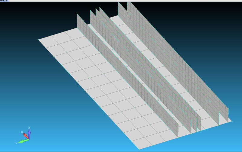

As you can see, one big surface with big mesh on which are lying other surfaces with different mesh. There are many ways to model this, one can split (in rhino or in femap also) the bigger surface on the location where the contact is and the merge nodes, otherwise you glue them, this is what i know can be done. The reason can be that you're not much interested in the big shell, you want to save elements and thus computing time, so you use different meshes; on the other side, starting to have 500 connections doesn't make things much easier. I am also curious if someone else is facing such big model (150.000 elements) using this new feature.
For Blas, thank you,you confirm the little i knew. Last, i'm building just half of the model respect to its longitudinal axis: can be a stupid question, but if i wanted to mirror it, i think i can't mirror all the connections, they are referred to geometries and meshes, and of course i don't want to start from zero with another half. Also what i discovered is that such edges, if belonging to 90 degrees surfaces, should belong to different regions (i often get an error like ''nodes not in topological order or branching'').
Thank you!

You can mirror surfaces, and automatically new regions & connectors will be created as well, this is nice in FEMAP and runs OK.
Is critical to apply mesh attributes to surfaces geometry, this way when mirroring surfaces you will mirror properties as well. All geometry will have mesh attributes, don't forget this important detail.
I run big Shell models as well, combining all techniques: glue surface-to-surface, glue edge-to-surface, glue edge-to-edge, and also NonManifoldAdd Surfaces, this last resource is very, very practical & powerful indeed. Take care with proper surface orientation (Top/Bottom faces compatibility!), when meshing with Shell elements this is critical as well!.
Branching is a problem when you define regions with multiple branchs, this sould be avoided at all, gives error. An edge region should be defined between consecutive grid points. The grid points defining the edge region must be entered in a continuous topological order. If an edge region or curve forms a closed loop, for example, the grids around the perimeter of a cylinder edge, the last grid point identification number should be the same as the first grid point number.

RE: Big shell model problems with 400+ Connectors
thank you for your , as usual, very useful advices.
I just mirrored the surfaces and as you said connections regions are mirrored as well, i just get an error when i try to merge the nodes on my simmetry axis, which goes:
nodes not merged due to Output Coordinate System conflicts!
If anyone knows anything about this i would like to undestand more.
Best regards,
Zwicky.
Yes, simply use "Modify > Update Other > Output CSys... ", select ALL nodes and assign the GLOBAL CARTESIAN "0. Basic Rectangular" coodinate system, and you are done. Next, do the node merging process as usual.
