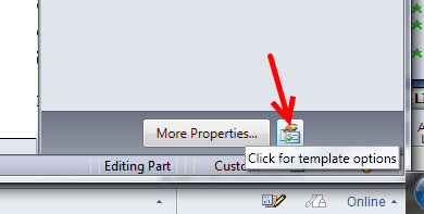

I don't know how MS Office is the issue, but if you are using the Property tab builder to autofeed your properties, try and first reopen the property tab builder, open the file. Reattach the property links if it looks link some are in the wrong place (sometimes happens here) and resave the properties from within the builder and do that for all the property tab files. Have the user restart SW, open up the file and launch the property tab in the Task pane and if they are still not appearing try checking File\Properties to make sure they can see the properties at all.
The other thing to check is the link in the bottom corner of the Custom Property tab within the Task Pane. The hand holding the option paper (similiar to the Tool\Option icon). Make sure the path on that 1 persons machine is looking at the newly created file you made... I have had users pointing to older versions, even after a new install.

Looks like the image did not work... try this link instead

Yes, I have reloaded the property template from the template options button in the task pane, doesn't fix.
