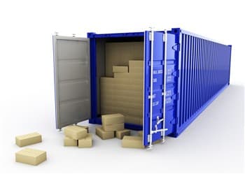

A seacan is a big rectangular metal box that is easily transported by trucks and boats, check out the image below. They're really sturdy and can be used for more temporary or mobile processes like the one we're working on. I saw a drag reducing agent injection skid that was inside a seacan a little while ago, kinda neat.
