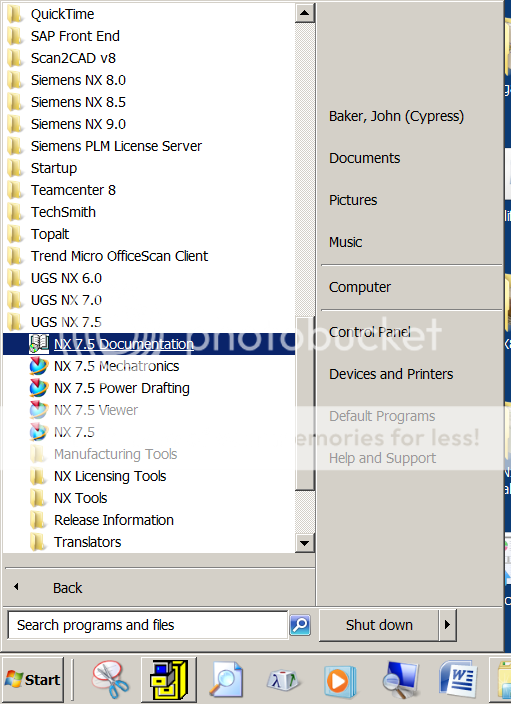

RE: NX7.5 - Synchronous (FACE MOVE)
Actually, if NX and the NX Documentation was properly installed on your system then you should have direct access to the NX Docs from the Start menu, as shown below:
Great, thanks again for this last NX Documentation access!!
