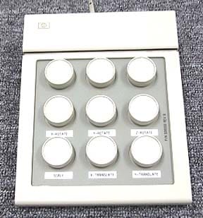

Just to be clear, I have NO issue whatsoever with people who prefer to use the so-called 'Ideas' approach of using the 'F' keys for display manipulation since we've provided you with the means to do just that, using the environment variable mentioned earlier in this thread. However, the reason that it IS an option, and one that requires something more than a simple toggle in Customer Defaults, is because those of us who grew-up using UG/NX have had access to both Mouse-gestures and Spaceball devices for many years and are more than satisfied continuing to use these 'traditional' approaches. After all, UG/NX has supported some sort of 3D hardware control since the mid 80's, first using dial-boxes on some specialized workstations...
