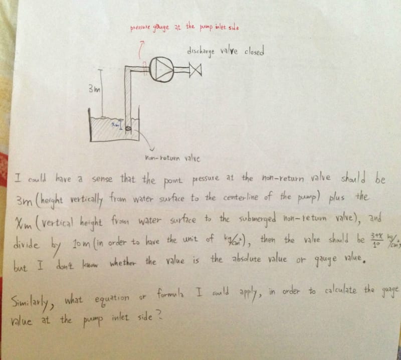

Dear good BigInch:
My gauge is a compound one, -0.1~0 is measured in cm-Hg, and above zero is 0~4, measured in KG/cm^2.
And later I think my above hypothetical gauge reading “ -0.3kg/cm^2” on the very beginning of the pump inlet side is wrong.
In the situation of which the water source surface level is under the pump centerline, the gauge reading on the very beginning of the pump inlet side should be “0 kg/cm^2”, am I right on this hypothetical assumption?
Sum up the above information, I have few questions confused me once more.
First is in the situation when water source surface level is 3m above the pump centerline, make the H(pipe line loss)=0m, and H(inlet water velocity)=0, then the gauge reading on the very beginning of the pump inlet side would be +0.3kg/cm^2, and the gauge reading on the very center of the impeller eye would be -1kg/cm^2(vacuum state), and then the water would be pushed by the “mysterious force”, from a higher pressure zone, +0.3kg/cm^2, moving to a lower pressure zone -1kg/cm^2(vacuum state), am I right on this concept?
And the second is in the situation when water source surface level is 3m under the pump centerline, make the H(pipe line loss)=0m, and H(inlet water velocity)=0, then the gauge reading on the very beginning of the pump inlet side would be +0.0kg/cm^2, and the gauge reading on the very center of the impeller eye would be -1kg/cm^2(vacuum state), and then the water would be pushed by the “mysterious force”, from a higher pressure zone, +0.0kg/cm^2, moving to a lower pressure zone -1kg/cm^2(vacuum state), am I right on this concept?
Still thank you for every good, hospital, generous seniors who teaches my so kindly, despite my question is so basic and dumb, really thank you.

RE: Theoretical calculation does not match the practical gauge reading on pump suction side
Glad to know you have a vacuum capable gauge. Some people get puzzled by that.
As velocity slows, static pressure increases. Are you entering a larger suction pipe diameter and not accounting for velocity head effects? It is customary to ignore velocity heads, but they can make small differences.
Can you make and post a diagram of the suction piping please? Click on ".. or upload your file to ENGINEERING.com" line down there at the bottom of this page.
It's not necessarily atmospheric pressure doing the driving. Flow is driven by whatever is causing any pressure differential you may have between any two points in the pipe that tries to drive the flow of the fluid inbetween. If connected to a closed tank, then it's tank pressure on one side and γ * ΔElev on the other - flow friction on the other side. The water column will move as it tries to balance the two pressures with its own weight plus the frictional forces if it does wind up actually flowing. At least if the system is in a gravitational field. If the system is in outer space, then it's flowrate will change until the pressure differential is balanced by the friction produced by the flowrate alone.
