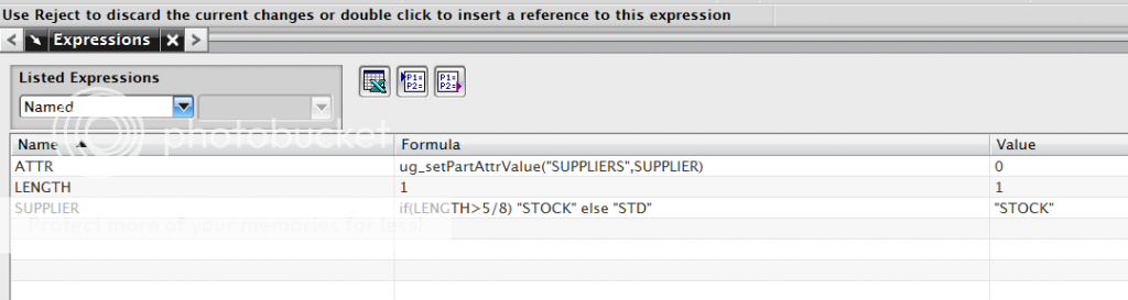

I created an Expression: SUPPLIER-----if(LENGTH>5/8) "STOCK" else "STD" (DISPLAY VALUE ="STOCK")
Then I created another Expression: SUPPLIER_ATTRIBUTE-------ug_setPartAttrValue("SUPPLIERS","SUPPLIER") (DISPLAY VALUE =0)
When I checked the Properties Attribute the VALUE = SUPPLIER but I need it to say "STOCK" is there any way to get this to work? PLEASE HELP

Your expressions should read like this (note the lack of "quotes" in second field of the ATTR expression):
This will result in the attribute SUPPLIERS="STOCK" being created

Wow that was simple,
Thanks John
