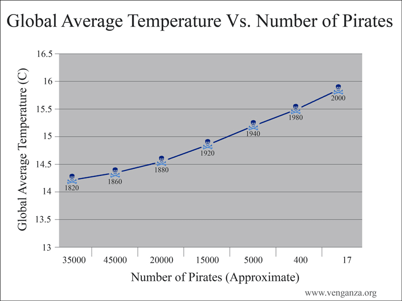

Your Smithsonian link reminded me of another link to that site. This one shows how well the Limits to Growth predicted 30 years out.

Computer models don't even have to be based on any physical laws to get things right. Google "Artificial Neural Networks" and spend a couple days reading. All you need, to create a model that has great predictive power, is lots of historical data to use as inputs and outputs. Then train the model to that data.
The idea that models can't be used to predict is silly. Of course they can be used to predict. Otherwise they'd be pointless. And they don't even need to be based on science if you have enough data. You can use ANNs to predict football games.
What they CANNOT do is prove causality. This is always the fun example, with which most engineers will have some familiarity:
Now sloppy graphing aside, one can show an inverse relationship between the number of pirates vs global warming. One can even tune a computer model to show that, and get a correlation between the two that's not terrible. What you can't do, is use that model to prove that one caused the other, when there may be entirely different factors in play that could be causing both.
In the global climate environment discussion, it's not just carbon that's increasing, it's everything else that mankind does to manipulate our environment that's also increasing. The things tracking 'upwards' are temperature and people. That antropogenic carbon is on the rise is incidental to the fact that *everything* humans do is on the rise. The model trained to carbon proves nothing. You could train a model to the length of roads, or the number of buildings, or the number of printed books, or CFCs (apparently) or who knows what and still get a high correlation. But correlation does not mean causality.
A model specifically trained to follow a correlation is not proof. It can't be proof, by its very nature. Lots of scientists are forgetting that these days.

How about an outbreak of Nigerian Pirates?

Or pirates - never forget the pirates.
RE: The Fallacy of Extrapolating with Computer Models
Or pirates.
Which means "proof" of CO2 as the primary driver isn't proof at all.
