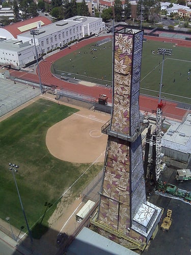

A fair number of those Huntington Beach wells were still there (at least the ones on solid ground) in 1977 when I visited SoCal for the first time. Being from Michigan, seeing those wells strung along a sandy beach with only PCH between them and the surf was sort of shocking. Not that we didn't have oil wells in Michigan, just that they were always just one or two stuck out in the woods or near the edge of a farmers field. Granted, I'd seen big oil fields in Texas and Oklahoma but then they looked exactly like you'd expect them to, not adjacent to a surfing beach. But then there's that oil well on the campus of Beverly Hills high school:
Of course they've dressed it up a bit winky smile

RE: The USA: energy self sufficiency - political myth or reality?
There are wells offshore Long Beach that have sheet metal palm trees on the superstructure. Which is funny because if you turn the other way you see the eyesore that Signal Hill has always been (when I was about 12 I used to ride my bike in amongst the pump jacks on Signal Hill so that we could get a long downhill ride back to Lakewood, today they likely make local kids sign a JSA before riding up there).
I worked on a well within the city limits of Traverse City, MI that was drilled (and frac'ed) in the 1970's. There are nearly 500,000 gas wells and a few more oil wells than that. Call it a million wells in the U.S. Add 100,000 in Canada and about the same in Mexico. Every one of them was at least considered for fracture stimulation and something over 80% of them were subjected to that treatment. Call it a million frac jobs in North America. Not all achieved their stated objectives, but all were done with a high degree of safety for the public and public resources like water wells.

Yea, I sailed a 'Hobie' cat (actually someone else was doing the 'sailing', I was just hanging on for dear life) out around one of those camouflaged 'oil islands' in Long Beach Harbor while on that 1977 trip, just to find out exactly what they were (they looked so beautiful at night, all lit up, that we just had to see what they really were):
JRBaker,
Very nice and certainly distinct from any wells -sputter and rotary- that I've had the chance to meet. Rather than a 'Hobie' cat and bay, a '49 Power Wagon and mud was always fun but I'm sure there are big 'dog house' differences,,,undoubtedly 'payback' for my years on the mining side.

I don't know guys about the colorful work over rigs. Most of the newer wells I saw growing up, had no tall structures. This maybe different for off shore, but land based shoulden't have tall structures that remain after the well has played out. Now let me tell you my complaint about wind power.

@JRB ... hiding in plain sight ? ostentatious camouflage ?
