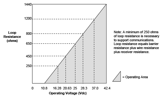

For 2 wire loop powered (passive) analog outputs there's usually a graph, sometime called a 'load line' of resistance vs voltage because higher wiring resistances can be overcome by increasing the power supply voltage:

The loop's resistance is the total of the dropping resistor on the analog input(s), wire resistance and the intrinsic safety barrier resistance (if used).
The ISA 50 standard, now the ANSI/ISA-50.00.01-1975 (R2002) [Formerly ANSI/ISA-50.1-1975 (R1992)], entitled Compatibility of Analog Signals for Electronic Industrial Process Instruments says that 4-20mA outputs should be able to drive a minimum of 600 ohms, but there are numerous signal conditioners that top out at 500 ohms.
In the process world, most AI's are 250 ohms or less, so for short to medium runs of wire, a 24Vdc power supply is adequate, as a rule of thumb. Long runs of wire, 10Vdc inputs that use 500ohm input resistors, or loops with more than one receiver AI warrant a closer look at whether the AO can push the current through the loop.
