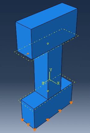

Moving on to a column (which is not a unit cube), let's say that I have loaded this column in shear, how would I determine the failure load? Meaning, after applying a displacement, how would I get the output for the failure load, assuming I am still using the Concrete Damage Plasticity Model.
For the unit cube, I just examined the force vs displacement at the "Load Node" which is the node I applied the displacement to. However, for a column, you don't necessarily know the exact point, how would I extract that information. I will post a picture to show you the column setup I have. I am applying the displacement on the top part above the column but want to determine the failure load in the column.
Here is the link: Link
Not sure if I can post it this way but I will try:
