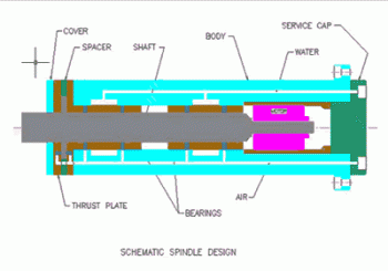

In continuation to this, suppose, the shaft is in rotation and an air-film profile like above (image) is created. At this point, suppose I introduce a small static load (non-contact loading) on the tip of the shaft (far left). Below is a section view of one such spindle consisting of two journal bearings (brown in color) with shaft (grey) which is rotated by an electric motor (pink).
Now my question is: Does the stiffness of shaft (while in rotation) will vary with the angular location to counter the torque applied by the small static load at the tip of the shaft (far left)?
My argument: Since the air-film has a unique profile due to the rotation of the shaft, its load carrying capacity might not be same at each angular location. For instance: the angular position where the film-thickness is minimum is a high pressure point. If I try to apply a load in the direction which further tries to compress the air-film, I may not be able to do due to high stiffness. Does this makes sense?

For the type of air bearing spindle you show, air is introduced into the bearing through a number of "Jets." These are usually small diameter restrictors. The interaction between the restrictors and the shaft gap keep the shaft centered and also determine the stiffness of the bearings.
