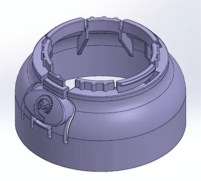

We experience severe living hinge delamination problem. We suspect excessive 1.Frozen Skin formation and the consequential 2.high Shear rate/Shear stress during filling due to hesitation flow in the hinge caused by apparently improper gate location. The latter is too close to the hinge resulting in the following filling dynamics: while the gated side of the box fills relatively easily, the flow is slowly crossing through or even stopping in the hinge; the resultant, significant Frozen Skin restricts the flow channel. Due to the latter event and the sudden climb of injection flow rate through the hinge (after the completion of filling of the gated box half) the Shear rate rises remarkably causing high Shear stresses among the layers of laminar flow leading to delamination. We will run a precision Flow analysis to test this hypothesis. Please post another possibilities, help is appreciated in advance.

Indeed, it sounds like you have a gate location issue.
The flow of the material needs to be right. In other words the cavity needs to completely fill before the flow reaches the hinge area so there is no hesitation effect.
Try injecting the material faster and also make sure the venting is adequate before changing the gate location.
Hope this helps.

I'm surprised that with all the services you advertise on your website you did not work out the correct gate position and carry out a "precision flow analysis" before the tool was made.
Have you a picture of the problem you could share with us?

Paul, thank you for your feedback, we plan to 1.compute/try faster injection, 2.increase lining hinge thickness while computing the major principal strain in it to stay as far away as possible from the material's elongation(strain) at break value and 3.relocate the gate as the last resort. How does this plan sound to you? Thank you in advance.

That sounds like a good plan. Did you also consider increasing the back pressure during plasticizing to help the flow?

Thank you for your continuing feedback. We folded a few times the living hinge (attached to apx. 7*8*2.5 inch tall box halves) as soon as it came out from the mold causing high level of advantageous molecular orientation and it worked flawlessly without delamination. One time folding was OK, multiple ones gave significantly better results. However, it required an operator, which adversely affected the profitability of the project. Since then we ran an initial Flow analysis and found horrible shear rates and shear stresses in the hinge, way exceeding the allowable percentage (apx. 1) of room temperature tensile strength of the resin. Interestingly the level of Frozen Skin formation at the instant of cavity fill was not excessive despite the early hesitation flow in the hinge - probably the speeding up flow remelted it, which could be another culprit for delamination - please comment. It seems we actually have to slow down the flow, permitted by the low Frozen Skin level, in order to improve shear conditions. The plan is to compute optimal filling conditions (inj. time/melt temp./mold temp.) and run a designed OFAT (One Factor at a Time) molding trial or better yet, Designed Experiments (DOE or DOX) to see whether we can avoid the cost/time of relocating the hot gate requiring even the addition of a hot manifold into mold. Thickening of the hinge is another option; your comments are greatly appreciated.
