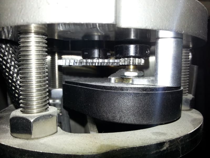

I seem to be having problems with two different material gears meshing together. In certain cases, I see a a lot of metallic dust accumulate (as shown in the pictures). I assume that is because of the wear between the two gears.
Detailed info:
The larger gear is made out of aluminium (anti-backlash gear)
The smaller gear is made out of stainless steel
No lubrication is currently used
Rotation speed of the larger gear is very slow, maximum 10 RPM
Rotation is oscillatory covering 90% of the larger gear
How should the design be changed to solve this issue? Should both gears be made out of stainless steel? Should we use a lubricant, which type?

The larger aluminium gear is being eroded by the smaller stainless gear.
The metallic powder is clearly coming from the meshing. There is no obvious signs of wear between the two halves.
There is practically no torque being transmitted between the two gears. The black box in the lower half of the image is an optical encoder.
The product was designed not to require maintenance on this part. After about 1 year of operation or less, the part has to be replaced.
This is a design flaw and I am trying to find the cause to increase the reliability.
Why shouldn't the two gears be made out of stainless? From my understanding, I should try to maximize my gear surface hardness and aluminium is not that hard.

I would suspect the tooth loading actually comes from the anti-backlash mechanism. Is it an off the shelf item? If so, is it available with a weaker spring?
It's tough to see end-on, but the tooth profiles look a bit...funky...to me. Are they involute?
How well is the center distance controlled?
I would cast my vote for trying a nylon or acetal gear on one of the pair. Aluminum and stainless both love to gall given half a chance.

Looking at the photo again and zooming in for a better look I can see what appears to be evidence of hard meshing. There is damage to the tooth tips.
Are the mating gears set at the correct mounting distance?
It looks to me like they are meshing too close to each other.

I spoke with one of the engineers that makes the anti-backlash gears (SDP/SI) and we arrived at the conclusion that the two biggest factors involved are : control of the gear distance and lubrication.
The design allows for the encoder to be moved back and forth (thus modifying the clearance between the two gears). Unfortunately, it is too easy to put the gears too close to each other or too far. For these anti-backlash gears, the manufacturer recommendation is center distance = (Ng+Np)/2P + 0.0015". Controlling this distance with more accuracy would certainly reduce wear.
On the topic of lubrication, a dry film lubricant is something that should work well. I'm going to test Molykote 321 (Molybdenum disulfide) on this system. A multi-purpose lithium grease (NLGI 2) could also work, but I'm worried about dust and it falling on the sensitive components below.
If neither of these two solutions work, then I will investigate the materials used and try a different combination such as aluminium on brass.

I've seen the same result before. Small areas of the aluminum stick to the steel part and then get wiped off during the sliding action. The answer is to prevent that sticking. Tried dry film lubricant, but it wears off very rapidly.
Hard anodize should help as the oxide layer won't stick to the steel. Polishing can help to prevent abrasive wear. Adding a felt pad on top of the split gear and adding oil to that should lubricate the mesh just fine without dripping or moving around. That's what's used to lubricate home furnace blower motors.
A remark on the tip damage - at the end of tooth contact there is significant sliding. With adhesion it will tend to pull a burr off the end of the softer teeth. I suppose if it got long enough, the burr would interfere with the root of the mating gear.
As to the use of stainless - The key to picking the right combination is to make sure the two materials do not tend to gall. The reason stainless is stainless is the formation of a protective oxide coating. Just like aluminum, sliding will remove the coating in tiny places, which can then weld and tear loose. Unlike the aluminum, the material could remain stuck and form high spots that continue to do damage. Been there and done that.
