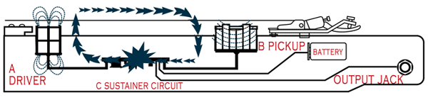

So I made a guitar sustainer (basically an AC electromagnet, with a permanent magnet on the bottom top pull the strings down in the absence of any AC signal going through the coil) - it works ok but the driver coil/core gets extremely hot ...especially at high frequency (frequency range is up to 5khz). I'm presently using a mild steel core (which isn't optimum, but easy to source!), but really should be using electrical steel laminations for the coil core.
For the least eddy current induced heat, which way should the laminations be orientated, I've done this (bad) drawing to help....
Bearing in mind where most of the magnetic direction force/flow is, which option would be best for the lamination orientation? Option 1, option 2 or option 3?
Also all related tips welcome! (type of laminations, supply source (I'll be ripping upa transformer for my immediate source!)

Use option 2 to minimize the path lenght of eddy current, so less eddy curent losses.
Decrease lam thickness. in some range of thickness and applied current, losses in inversely proportional to the square of thickness.
yes, FeSi should be better than mild steel, if no choice, make sure mild steel is annealed.

Option 3 will still help and be a LOT easier to make. Just the change from mild steel to silicon iron is a big improvement due to higher electrical resistivity. You might want to consider 430FR stainless too, it has even higher resistivity than silicon iron and won't rust. The saturation flux density is lower but I doubt that is a problem in this device.
I don't think annealing the mild steel will help the heat at all, annealing has no effect on resistivity. Annealing will affect the BH curve and the coercive force.

The annealing could help a lot if your mild steel was cold rolled. It is true the resistivity will not change a whole lot, but decrease in area of BH loop will decrease hystreresis losses very effectively. Under a relatively low frequency of 5khz, the loss component from hysteresis losses can be still high.
Option 3 is viable, but never option 1 in which the lam structure will not help much.

the problem is, the thinnest strings on a guitar need quite a bit of current through the coil (& quite a few turns too!)...in fact I've been on a fair while getting as much magnetic drive into the core as possible (to assist in getting the thinnest strings to sustain well), so any thought of now backing off the magnetic intensity to reduce eddy current heat isn't that paleteable!

The permanent magnet on the bottom of the core acts akin to a 'bias' ...it attracts/pulls the strings down in the absence of an AC signal through the coil. When an AC current runs through the coil, then the core's magnetic 'pull' is both reinforced & (to an extent) negated ...this is what causes the the string to vibrate in both directions (up/down)...remember you can't push a ferrous string, so the trick is to pull it down with the permanent magnet, then 'releas'e the string from that pull by overiding it with an AC signal....a faked 'push' of the string (which is not a push at all...it's a release). The sustaining function is very much related to current through the windings ...because it's only if you have enough current & windings, that there's an impact on the core (which is magnetized by the permanent magnet)

Sure, a guitar pickup senses the string...that signal is then buffered/amplified and fed to the driver coil. The AC signal (i.e. as sourced from the pickup) modulates the permanent magnet field acting on the string...which causes the string to move in sympathy with the original string vibrations.

A little bit more info (because it seems there's many trying to tell me how a sustainer works!)...I've actually got the sustainer working well (it has been a long journey & belive me, I've tried every permutation known to man!), the last 'challenge' is the magnetic core material. I was happy enough with a mild steel core until I used the sustainer heavily in harmonic mode...this particular mode sees much higher frequency going into the driver coil & it's then that the driver becomes too hot to touch, hence me posting abouut lamination orientation (I still believ that this is eddy current related as at lower frequency the core isn't anywhere near as hot)
In short, the sustainer *does* need a permanent magnet (the goal is to move the string both 'sides' of its quiescent rest (up/down)...but since you can't push a string with magnets, the only alternative is to 'release' a permanent magnet's hold on the string)
