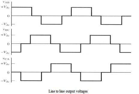

Google of LCI VFD torsional leads to some info:
http://turbolab.tamu.edu/proc/pumpproc/P24/10-kais...
Quote:
Any practical VFD powerful enough to run a pump cannot
operate as a linear amplifier, but must resort to simple “on” or
“off ” states of the power electronic’s switches. Because of this,
there will always be harmonics present in the output voltage and
current of the VFD, which is applied to the motor. Due to the
three-pole output structure, the harmonics are all odd, with those
divisible by three being absent (a pole is the power electronic’s
block that creates the output to one phase of the motor). The lower
order harmonics (five, seven, 11, and 13) of the fundamental
output frequency cause the stator MMF angular velocity to
fluctuate slightly. That causes the angle between flux and MMF to
vary with a characteristic pulsation frequency. The fifth and
seventh current harmonics cause a torque ripple six-times the
output frequency, and 11th and 13th harmonics cause 12th order
harmonic torque ripple and so on. Of course the amplitude of the
torque ripple is proportional to the amplitude of the current
harmonics. The poorest performing VFD in this respect is the
load commutated inverter (LCI). This VFD creates a smooth direct
current (DC) link current and switches it into the stator windings in
a prescribed sequence. The quasi-square wave current causes the
stator MMF to advance in steps of 60 degrees electrical at each
commutation (a commutation is the transfer of current from one
power switch to the next one in sequence). An LCI with two parallel
circuits operating into a dual winding motor (12-pulse output) creates
3 to 8 percent torque ripple.
Another popular circuit, the neutral point
clamped (NPC) circuit has five voltage levels from line-to-line and
uses pulse-width modulation (PWM) techniques. Depending on the
frequency of switching, the current is less distorted and the torque
ripple decreases into the vicinity of 1 percent to 3 percent. A third
architecture, the multilevel series-cell circuits, can further reduce the
current distortion such that the torque ripple decreases to 1 percent
of motor base rating. Multilevel series-cell circuits also apply PWM
technology. Figure 19 displays voltage waveforms produced by
LCI, NPC, and multilevel series-cell (PWM) VFD architectures. For
the LCI drive system, it is usual practice to perform a torsional
rotordynamic analysis of the drive train, investigating critical speeds
with LCI-VFD torque harmonics.

Here is my attempt to digest this into something simple enough I can understand:
As mentioned, the current to the motor changes in steps. Seems counterintuitive at first, but not when we realize the current is not interrupted but switched from one phase to another (and taking advantage of machine voltage to help with commutation).
So for 6 pulse converter, the current and mmf vary through 6 discrete states in the course of one electrical cycle, so 60 degree step change in mmf at the moment of switching. The torque is given as cross product of rotor mmf and stator mmf. The rotor mmf is varying smoothly while the stator curent is varying in steps, so it is easy to see the resulting torque will vary over the course of that 60 degrees: highest just after the stator step change, lowest just before the next stator step change.
I gather 12-pulse results in 12 discrete states in the course of one electrical cyle, so 30 degree step in mmf at the moment of switching and smaller torque transients than for 6-pulse, although the two references did not agree on amount of torque oscillation expected.
(2B)+(2B)' ?
