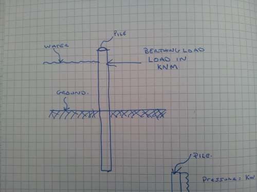

Im doing a piece of coursework on the design of a monopile in a river.
My first question is really simple. I have calculated a berthing load from a ship using BS6349-4. I would have expected the formula to give me a load in KN, however it gives me a KNm moment. I am a bit confused as to how i can apply this moment to my pile design. I have calculated it has 40 knM but cannot get my head around how this can be translated into a force so i can check bending, shear etc.

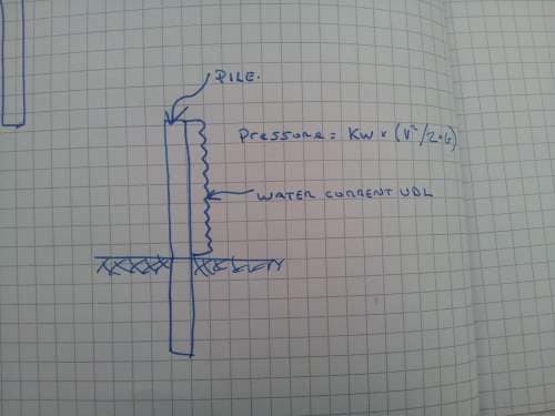

My second question is regarding water current pressure on a pile. I found a formula in "Design Of Bridge Structures.  By T. R. Jagadeesh, M. A. Jayaram" (see link). It gives me a formula for water pressure but mentions that the force is 0 at the base, how exactly does this work with the formula found on page 84 ?
http://books.google.co.uk/books?id=_JgMVVqDgBIC&am...
The pile is going in an area of fairly high flow so water pressure is obviously important.

No course work questions allowed.
Velocity of any fluid is zero immediately next to a fixed boundary surface.
