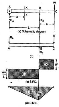

Is the break on the rotor side of the bearing seat?
RE: rotor shaft fracture
Quote:
But with the belt tension and pulley over hang, wasnt the shaft supposed to fail after the bearing journal - pulley side not rotor side
The failure presumably occurs from bending stress, which depend on the moment.
So we can analyse using a shear a bending moment diagrem.
If it's a ball bearing, then as Tmoose taught me once (I think it was him), it acts like a simple support.
Simple support exerts no reaction moment, so there is no step change in moment at the support (you'd have to move a distance away to see a change in moment). So the moment immediately on one side is practically the same as the moment immediately on the other side. Without a big change in moment from one side to the other, the location of highest stress concentration would be most relevant in determining location of failure.
If cylindrical roller bearing, I'm not sure how to model. Seems like it would be more capable of exerting a reaction moment than a ball bearing.
(2B)+(2B)' ?
A diagram of the shear and bending-moment diagrams, which I believe are applicable to this case:
The motor bearings are at RA and RB, being the "rear" bearing at A and the "shaft" bearing at B, and the pulley load is at C.
I'm surprised to see the fracture on (what appears to be) the LEFT side of RB.
That may be why many responders are considering the possibility of an initial flaw on the shaft, even while many others are looking at the service loads.
