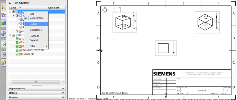

RE: Huge Project and Whole Drafts to Update (How?)
Here is some pictures
Before change:
After change:
how to update:
Seems really easy? try it with a 1000 part project...

Hold it a second,
in the three images above, "The unwanted lines": , May i assume that 1) this is the sketch and not edges of the solid body ? and 2) ( not assuming) this drawing is made inside the same file as the model .
Then 1:) If you desire to care for "curves" in the drawing view, there is an extra option under the hidden line options, "Include model curves", which is off by default. the reason for the off state is that NX will need extra computing time if we mix the object types, and performance is a big desire. So yes you can mix object types but it will take longer time to compute hidden lines.
If you desire so you can have the extrusion hide the sketch, ( Make Sketch internal) and it will not display elsewhere. Both as a default setting and a per feature definition.
Or, if you work with other types of features which doesn't have the "make internal" option, the standard procedure is to move the curves/ sketch to a hidden layer.
then 2:) If the model and the drawing would have been in different files, the automatic reference set handling would have had excluded the sketch from displaying on the drawing.
Model and drawing in separate files is the recommended practice since at least 15 years.
The tip from Jerry1423 does work ( if you also follow what I wrote above), all you need to do is display the drawing/save/plot. The setting is part-specific and will be stored with the part. You can also set this in the customer defaults for future files.
The reason it is delayed by default is if your models are complex and the updating therefore takes notable time, It might in those cases not be desirable if NX starts updating as soon as you display the drawing.
If one desires to update drawings in batch mode, one can do that by using the Refile utility. There is a specific option to update drawing views. ( Refile will re-save the file after the update has finished.
