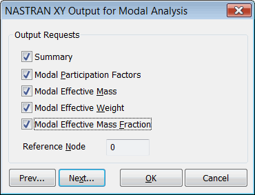

Hello,
I am trying to find a way to extract the mass participation factor from the Normal Modes/Eigenvalue Analysis for different natural frequencies. I receive 10 modes with frequencies and I need to see if the first frequency is dominating by checking if the mass participation is minimum 90 %.
I have tried to enable the "Summary" and "Modal Participation Factors" in the NASTRAN XY Output Modal Analysis Output Requests and chosed a reference node (is it required ?). How can I calculate or find the mass participation factor for each frequency? I have opened the file xxxxxx.f06 and I can see at the end of the file following information, but I don't know how to interpret this correclty (it should be 0.9 < mass participation < 1):

In the Output Request of the Modal Analysis (SOL103) simply select the first one SUMMARY and the last one MODAL EFFECTIVE MASS FRACTION:
After performing the Modal Analysis (SOL103) you will see in FEMAP different functions created of MASS FRACTION and MASS SUM in the three axis X,Y,Z, then simply plot them and you will have the mass accumulated mode by mode in each direction (SUM MASS) and also the fraction mass mode by mode ( MASS FRAC), is so easy:

RE: Natural Frequaency Analysis - Mass Participation Factor
I did not see that after the analysis FEMAP generates functions for this.
Best regards
I run FEMAP V11 & NX NASTRAN 8.5, maybe FEMAP with other solvers do not generate the mass participation functions. This is not a problema of FEMAP, but the FEA solver you use, then let us know the name of the FEA solver you run.
I run the same version as you so there is no problems
I just meant that I didn't see that FEMAP generates the functions automatically. I can see that now so there is no more problems. Thank you
