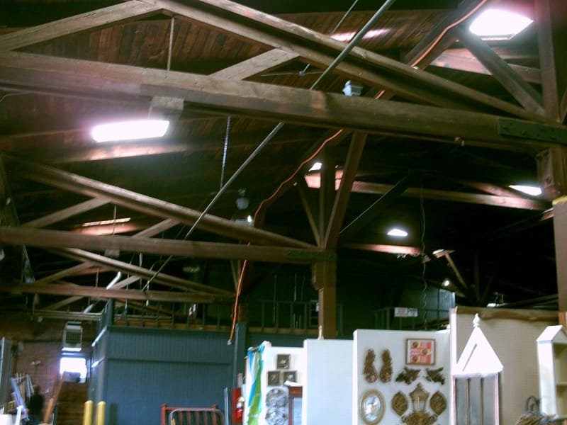

I didn't see any problems coming on this job. I can appreciate the water supply is marginal but that is what fire pumps are made for with the understanding fire pumps don't make water but boost pressure.
Flow test results 45 psi static, 27 psi residual with a flow of 628 gpm.
Addressing the minimum 20 psi suction with pump operating at 150% know I got it as demonstrated here:
Calculation from source to pump suction flange at 150 percent of pump rated flow
Calculations showing a minimum 10 psi safety cushion
Calculations demonstrating a minimum 10 psi cushion is available
I talked with the local authority having jurisdiction about the exceptions and even though I do not believe I need either of the exceptions available it would help a lot with local official granting the exceptions if they can be convinced the system is fully adequate.

The thing is the building is a 42,000 sq ft 100 year old wood storage building obviously without sprinklers that the owner wants to turn into a mercantile.
It's going to be an antique mart so plastics is not an issue. I love old buildings like this.
Sprinklers came about with the occupancy change from storage to mercantile and the thing is if this project doesn't fly I will live the rest of my life with egg on my face and the building reverts back to being a non-sprinkled storage building in a congested downtown area.
