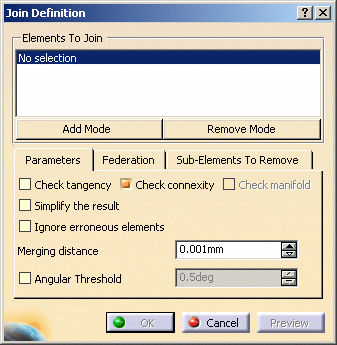

  • Some surfaces are not close enough to be able to close a singular volume by CATIA and in that case use the Join feature with Distance Propagation (right click in the window of the Join and click Distance Propagation) after selecting a face. In this case set a tolerance (Merging distance) big enough to be able to close the surface. More about this feature can be found here.

Please find the error i am getting in the snap shots attached when i try to join the surface with distance propogation.
ERROR : Some non manifold configurations are detected.they are not managed by join operator.Modify input bodies to suppress these non manifold configurations.

I am asuuming this is made up of several individual surfaces. If this was one surface, you would get a boundry. Try joining it to find the errors. You may have to break up the join (do 1 small section at a time until you find the problematic geometry).
Also if you have healing capabilities, this will help solve your problem.

Disassemble first, then try locally joining 1 area at a time to see where the issue is...
