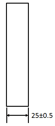

Given the following:
What is the tolerance on the Flatness of Datum Feature A?
a)The flatness is not toleranced.
b)0.3
c)0.5
d)1
Originally, I thought it was (a) because a +/- dimension is equivalent to taking a measurement with calipers/mic (meaning the only control is the width at any given point), so it would be possible for the part bow out and have a flatness greater than 1 while still having a thickness measurement of 24.5-25.5.
However, after re-reading over Rule #1 of the standard it seems that the correct answer is (d). If I understand it correctly, the application of the Taylor Principle to this problem means that the feature must fit within a perfect boundary of the part at MMC. In this case, the flatness on the feature could be as high as 1. Is this correct?

Yes, your latter thinking is correct. A "purist" might also add that the 1 mm flatness tolerance is only available to datum feature A if the opposite side is perfectly flat. But the gist of the question and your answer is all correct.
Are you sure about that, J-P?
Have a look to attached graphic. The way I see it - even with the opposite side not perfectly flat the flatness error of considered surface may still be 1.0.
http://files.engineering.com/getfile.aspx?folder=f...
RE: Application of Rule #1 (Taylor Principle)
Good point! I guess I was mixing the idea of feature-of-size flatness (where my extra statement would be true) with surface flatness, which was my thinking as I initially answered the question. Thanks for the graphic.
Actually, reading the original post, we don't know what datum feature A is -- it could be tagged with the size dim. But I suspect Sean meant that it was one of the faces, and either way the answer from the multiple-choice list is still d.
Sorry to muddle things with my extraneous comment :)
Quote (J-P)
Well, not exactly, J-P. Have a look to another graphic. (I assume that by saying "feature-of-size flatness" you meant "flatness of derived median plane of feature-of-size".)
http://files.engineering.com/getfile.aspx?folder=0...
Doh -- I'm really not with it on this one, am I?! I obviously know the principles, but I meant to write that the full 1 mm of flatness tolerance (on a FOS) is only available if the actual local size is at LMC.
How's that? :)

I see no datum feature A.
shaun8567,
In ASME Y14.5-2009, see figure 2-6. They do not show the numbers, but it is pretty obviously answer d.
In ASME Y14.5M-1994, the figure still is 2-6.
For any form control, the datum reference is not allowed, so the question itself is questionable, am I right?
Season
SeasonLee,
The datum is irrelevant to the tolerance specification. Calling up a datum was a good way to show us what surface he was referring to. It would have been clearer if the datum had actually been applied.
