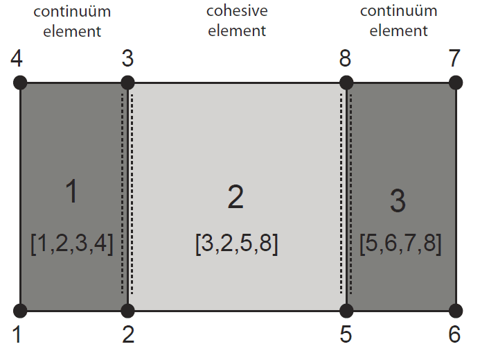

One other note, i found that it can occur that the standard node numbering in Abaqus for cohesive elements with a zero thickness is incorrect.
In the image below, when the cohesive element has a thickness of zero (thus node 3 has the same coordinates as node 8, and node 2 has the same coordinates as node 5) Abaqus sometimes defines the cohesive elements as [2,5,8,3]. When running the job for this kind of element definition, an error occurs wich says the surface of the element is negative. When adjusting the element definition of the cohesive element to [3,2,5,8] or [5,8,3,2] Abaqus now calculates a zero or positive surface for this element and the calculation runs just fine.

For your cohesive layer, first create the part with a thickness and mesh using cohesive elements (COH3D8). Second, assign the stack direction to the part with thickness so you can pick surface easily. Third, without converting to an orphan mesh, use the edit mesh tool to offset nodes from one surface to the other. The limitation here is that this only works with simply geometries like flat plates, but it works well for that case.

On this way i can indeed easy adjust the stack orientation.
