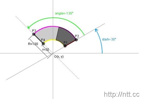

Thanks for the reply, but I already pointed out that I selected the Alternate Angle option referred to in that thread and it gives me a result that is 360 degrees minus the compliment of the angle that I'm actually interested in defining. This is the 225 degree angle that I referenced in my example. I'll try to attach a picture to this reply.
By selecting the Alternate Angle option, I get the entire circle excluding the angle I'm actually interested in...
RE: Angular Dimensioning
Of course the picture doesn't show... Here's a different one that should work.
In this picture, the angle of interest would be the blue angle, but the angle returned by the angular dimensioning tool returns the green angle. Selecting the Alternate Angle button returns a value for everything except for the blue angle.

So you're saying that you have 2 lines, P1 to P2 and P3 to P4, correct? If so, how does the so-called 'Blue' dimension have anything to do with anything other than the P1 to P2 line? And if you're really trying to dimension ONLY the P1 to P2 line, then that's NOT possible without something that represents the horizontal axis, either another line, or something like a datum CSYS.

You should dimension as P1->P2 and P4->P3 to get the 135deg angle

no, don't read into the picture too much. That is just some random picture I found because this site won't let me put in a url for a picture I have of the actual situation on my google drive. I'm not going out of my way to start an account somewhere that I can host a photo on so I can post a url of the image. In hindsight, I shouldn't have even posted that picture because it isn't close enough.
But thanks to WolframAlpha, I have a more accurate graph.
The line at 45 degrees is a feature on a part and the +x axis is a centerline through a hole that doesn't actually extend far enough to interesect with the feature. I want the 45 degree representation, but no matter what order I select: CW, CCW, farthest from intersection, closest to intersection, combinations of the possibilities: NX projects the centerline through to the other side of the feature and gives me the 135 degree angle shown. If I select Alternate Angle, I get 225 degrees.
I apologize for the confusion, maybe this graph will clear things up.
