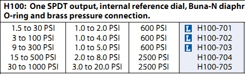

Manufacturer's pressure switch spec sheets provide a range of deadband values for any given switch because of the way mechanical tolerances add or subtract one another. In the example below, the deadband for the 3 to 100 psi switch (listing in first column) can be anywhere from 1 to 4 psi (listed in 2nd column).
Two identical models can have different deadbands within the spec'd range.
RE: Flow switch
We realize that you have a flow switch rather than a pressure switch, the pressure switch references are to illustrate dead-band.
