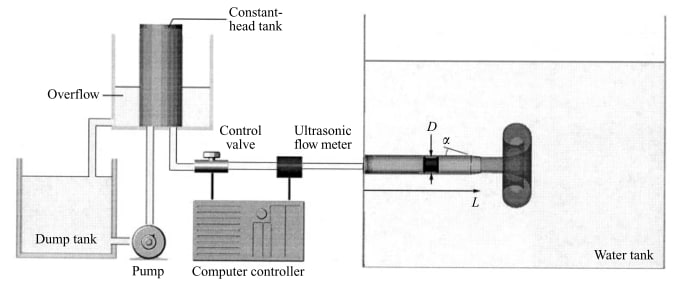

We're designing a flow experiment where we need to produce a controlled pulse of water in a pipe. Our current design idea is based on a constant head tank, a flow meter, a proportional valve and a control system as follows:
Image from Gharib et al. J Fluid Mech 1998.
External factors (room size, imaging equipment etc) limits this design to about 1.4 psi pressure in total. Previous researchers have used ASCO 8202, which seems like a perfect fit. However, the 8202 has a too low Cv - 1.1 gpm in the largest configuration - and we need to go to about 6 gpm for the flow rates we need, at this low pressure.
Does the valve forum know of a valve similar to the 8202, but with a higher Cv?
Thanks in advance,
Johannes

If you need solenoid type, Burkert goes up to 1" size Cv 5.8. Asco seems to stop at 1/2" and Danfoss stops at 3/4". Neither will get you to Cv 6.0.

OK, thanks, I'll look into the Burkert valve!
The Cv value is not set in stone - my rough calculations tell me that Cv around 5-6 should be appropriate.
The reason that I want to use a solenoid is that we need a fast reaction speed - we need to open the valve and close it again in about 300 ms.
Do you know of any other type of valve that can be used?
RE: Proportional valve for water, low pressure
Oh and another thing - the Burkert and Danfoss valves have a stated minimum pressure of 7 psi (0.5 bar). The highest we can go in the current design is about 1.5-1.7 psi.
So I'm thinking: Will these valve not open at all at lower pressures? Or will they work, but not optimally?

These are pilot-operated valves. In my experience, they will not open at lower than the minimum pressure.

I know from experience also that the Burkert 6223 will not open with less than 7 psi upstream.

You may need to use a small valve with pneumatic actuator, with a large solenoid on the air line that can open and close the valve VERY quickly
Might work with a pneumatic actuated butterfly valve, but the fastest actuators I know of would not respond much faster than 1 second for a close-open-close cycle. I could diagram a way to make a simple one-way plunger that could deliver the flow impulses you want at any volume/speed/stroke you could want, but you ought to be able to figure it out yourself: put a check valve on the head of the plunger, so it draws from the inlet tank on the return stroke of the plunger, and discharges though the outlet check valve on the forward stroke. Drive it with a regulated air supply, or from a hydraulic pump and variable speed motor, or via a motor and drive screw.

By controlled pulse I mean that I'd like the flow to vary as v = V*sin2(pi*t/T). Here T is the pulse time, about 300 ms and V is the peak flow, about 0.6 m/s.
