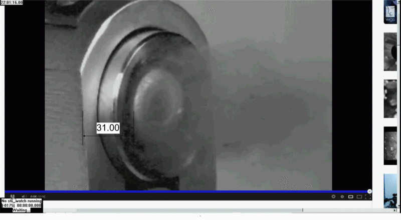

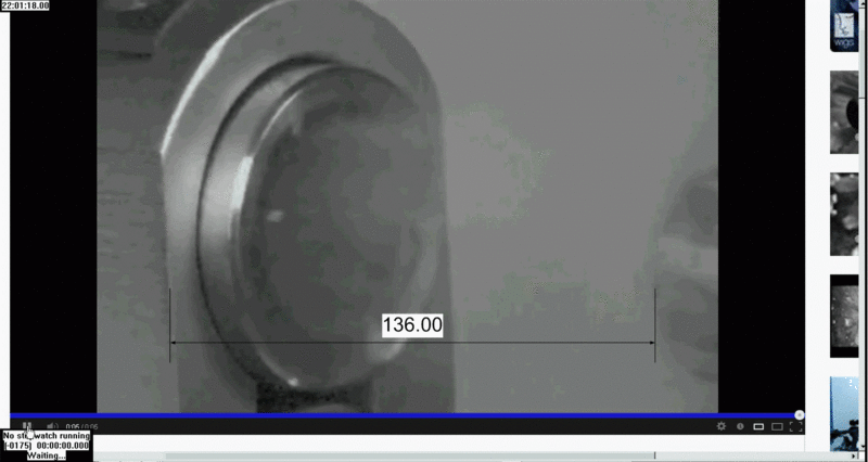

or inversely to the coyote effect??? LOL. If you stop and think about it though, the projectile is accelerating the entire distance of the barrel. Upon exit from the barrel, the gases are still accelerating for a brief moment before dispersing. I believe this gives the projectile a little extra kick, especially providing the friction has just dropped to near zero, or is actually at zero, considering the expanding gases briefly envelope the projectile at the moment of exit.
This isn't the best video available, but it's one I could find quickly (while still at work) http://www.youtube.com/watch?v=J6lA3ZsmJ4c
It also demonstrates the slightly imperfect gas seal between the bullet and bore.

"However, I have a personal theory that the sudden breakaway of the projectile upon exiting the muzzle, thereby effectively eliminating nearly all friction, has a catapult effect, coupled with the gases created from the propellant actually exceeding the projectile velocity and overtaking the projectile for a brief moment. The physics and math required to prove or disprove my theory are beyond my current understanding, but it could be tested real-world with the right sensors and cameras."
The fact that most streak camera images show blow-by around the projectile at the muzzle essentially disproves the "catapult" effect, since the gas that escapes around the projectile contribution nothing to its acceleration. Moreover, gases tend to take the path of least resistance, and the projectile provide an inertial obstacle, which causes the gases to go around the projectile anyway, not counting the fact that the gases want to expand in a spherical wavefront. The only reason gases provide acceleration to the projectile in the barrel is because it's sealed and the gases have nowhere to go. As for testing, the "right camera" would need to run a minimum of about 160,000 fps, given that the round is already moving 5.5 mm/frame; and any sort of measurement would need to run more like one million fps. That would get about .86 mm/frame of relative motion. Kurzzeit.com did it once in 2008 http://www.kurzzeit.com/eng/startseite.htm
If someone downloads the video, it would be possible to do a frame by frame relative motion measurement.
TTFN
RE: stupid question regarding projectiles
Quote (IRstuff)
...it would be possible to do a frame by frame relative motion measurement.
I've actually done that, NOT for anything nearly as fast as a bullet, but rather a test sample being stretched to the point of failure in a Tinius Olsen testing machine, back when I was helping a doctoral candidate with his thesis (I worked for the ME-EM department as a photographer my last two years in engineering school). Back then (this was in 1970/71) all we had was a rather nice 16mm camera which could be run up to about 180 frames per second. I developed untold feet of fine-grained black & white film which was then blown-up, frame-by-frame, to create actual photos from which you could not only see but measure the deformation of the test samples which were etched with a grid so that you could 'see' the progression of the elongating effect on the sample, right up to the point of failure. Hey, it put food on the family table winky smile

Again, the gas going past the projectile is lost acceleration, so not a whole acceleration to be gained. Since this is never going to end, I've done the frame by frame. As near as I can tell, there is almost no change in velocity
First frame:
Last frame:
Graph:
