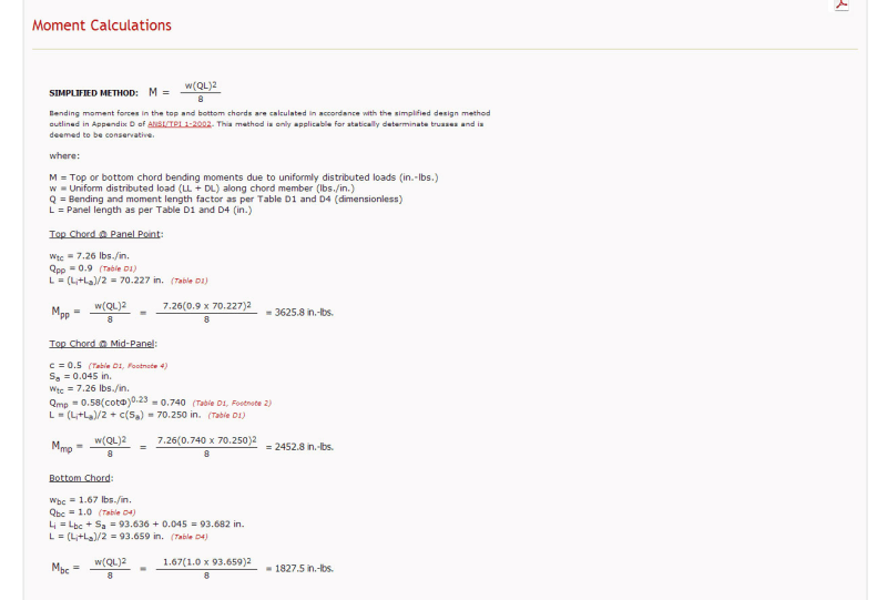

I've kind of hit a road block on the moment calculations. The current spec TPI 1-2007 calls for using the matrix method in determining the moments. However, I need to be able to run this app without doing a full blown analysis using RISA or some other FEA type product. For now I've gone with the simplified method which is the method used in the TPI 1-1995 standard, at least I can produce a solution. Typical result below:
If anyone has any ideas on how to do a simple matrix method analysis of a common fink truss please send me in the right direction. My biggest unknown with this would be how to deal with the fixity of joints at panel points and heels. I've just ordered a copy of Hibbeler's Structural Analysis to further research how best to deal with frames, trusses etc...
One thing I found really helpful was the samples provided in the previous editions of the TPI 1, its really quite disappointing to see no such example calculations in the current standard.

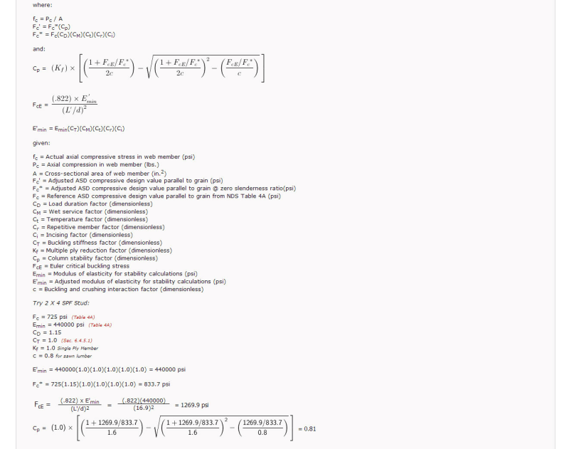

I've just completed the tension and compression web members for the fink truss. It took a little longer than expected but most of that was comparing notes between the TPI, NDS and "Design of Wood Structures" text. The rest was trying to format the equations correctly with html and finally resorting to LATEX and a third party program. Below is part of the calculations for a 4/12 fink truss:
My next hurdle is to try and program the top and bottom chord analysis however I am having a bit of trouble making sense out of the TPI 1-2007 when it comes to calculating the effective lengths for the chords, the previous method used in TPI 1-2002 seems a whole lot simpler than the current standard, it will probably take me a few days to mull it over.
RE: Truss Design Software
With a little help from a text called "Design of Wood Structures" by Donald E. Breyer and a recently purchased copy of the NDS 2012, the equations in TPI 1 finally made sense. I will say this has been quite an education with regards to structural design of wood structures. Last night completed the full lumber analysis for the fink truss. Top and Bottom chords as well as all the webs. Now its time to start working on the heel joint check and all of the connector plates. Wind loads might be next but I need to research this more.

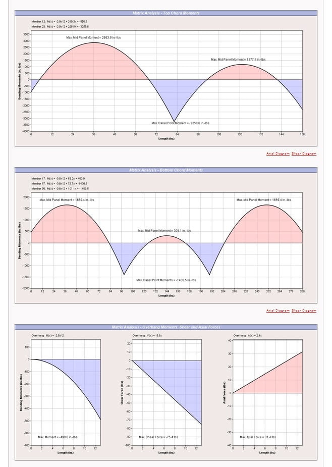

After about a good week of solid programming and scratching my head I've finally managed to add the requisite Matrix Analysis to my Truss Calculator. Thank-you R.C. Hibbeler for your Structural Analysis text on the subject (ch. 14 - 16), if the subject had not clearly laid out in front of me I would never have figured out the numerous steps to arrive at the solutions.
Here is an example of the output of my matrix analyzer for the Fink truss:
I've even inserted the correct code to account for the additional loading/moments if there are overhangs. I double checked my work by modeling up identical trusses (beams and trusses members) in both Strand7 and Solidworks (COSMOS/Simulator). My result were within 1.5% or better, so I'm really happy about that.
My only concern with my analysis is how correct my analog for the truss really is. What I mean is that the bending moments are heavily influenced by the amount of rigidity of the joints. Fixing the joints (where chords meet) or pinning them dramatically affects the bending moments and even the axial and shear loads to some extent. My analog model is basically rigid at the heel and peak joints and pinned at all other web-to-chord or web-to-web joints. This seems to approximate most closely the moments calculated using the simplified method (pre TPI-2002).
What I also found quite interesting (and expected) is if you use a stronger type of lumber on the top chord as compared to the bottom chord. The top chord loads increase and the bottom chord loads decrease. The matrix analysis is almost as good as FEA. It's really quite cool to be able to calculate something like this just using a bunch of matrices.
