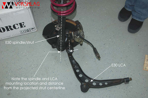

Hi there
I’m trying to set up an BMW e30 for drifting and after a good look at the front suspension I noticed the front axle was placed around 50mm forward of the bottom ball joint so that the front wheel has move left to right slightly and forward and backwards due to the 14.4mm scrub radius it has from standard I haven’t seen any other steering arm with the axel so far forward and wanted to know what the theory or reason was behind this before I start modifying it all
cheers
Just a pic of the bmw e30 suspension setup looking forward
This pic shows the later model e36 setup ignore the one on the left it the best pic I could find to help explain it better
RE: BMW e30 steering geometry
Hub lead is used to provide mechanical trail, which is used to set the compromise between being able to feel Mz, vs some self centring and linearity in efforts. Generally the mechanical trail at the ground falls between 0 (2CV) and 30mm. The castor angle needs to be considered when working this out from the side view geometry.
However from your drawing I see that I may have been misled by your use of the word forward and that you actually meant sideways.
If so then that distance, KPO, is set by the required scrub radius, which is a compromise between reducing the pull under braking on rough surfaces, parking efforts brakes on and parking efforts brakes off. And probably some more realistic concerns with packaging a given wheel/tire, turning circle, and a few other things.
Scrub radius varies anywhere between -20 and +100 mm, these days with PAS I'd expect to see +/- 20mm
cheers for that you were right with your first answer by the look of it, it will have little effect with what I want to do and sounds like there’s not much to gain by changing it either
I can understand mechanical trail can give you more feel from the front tires but when the car starts to understeer it starts to pull the steering wheel into the corner even more to the point that you have to force the wheel back the other way if it was a bike it would be called wheel flop if this is occurring then I can’t see how this would promote a self centring effect and with a bit of research into mechanical trail I found the scientific understanding of bicycle steering remains incomplete apparently according to"Chapter 8". Bicycling Science (Third edition ed.). Massachusetts Institute of Technology. I don’t know if the same applies to cars
once again thanks for the help smile
