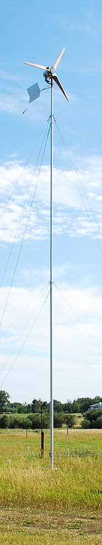

Neat idea for a discussion. Here's my contribution:
I built this wind turbine, mostly from scratch, starting in 2006 and got it in the air in the summer of 2007. The generator was replaced in 2010. The current one can pump out more than a kiloWatt when the wind is stronger than 30 mph. Usually it's not that windy, and I don't rely on the power for anything but back-up (the grid power goes out here often) and to supply some barns that otherwise wouldn't have any electricity at all. I don't meter it scrupulously either, but I estimate over 500 kWhrs per year (6-7% of my total consumption).
Blades: 96 inch diameter, carved from laminated cedar
Tower: 45 feet tall, tilts up with winch
Battery: 24V @ 880 Amp-hours (removed time-expired from internet service provider's backup power system)
Generator: permanent magnet brushless (converted from a 3-phase induction motor)
This summer it's due for a tear-down, new chassis, and 12 feet will be added to the tower height. Will probably need a bigger winch too.

Lionel: Yes, and your question is answered in the photos I posted on my journal webpages. Rather than force you to go look it up though, since I've done a number of these projects, and only one is on that tower now, I'll tell you some more about the current one. At the time I was able to use the machine shop at work for personal hobby projects (alas, I cannot any more). I started by taking an old Baldor induction motor apart. I have no idea why these things get junked when the wires are clean and the shaft is true. I pushed the induction rotor off of the shaft, and press-fit a bored steel cylinder in its place. More iron means a better circuit for magnetic flux. The cylinder was machined with flats on it for the magnets to rest on. These I attached with brass screws and adhesives. I won't try to explain the pattern of magnets, but if you're curious go see the pictures. The diameter of the magnets just fit inside the stator. Turns out I left about 1/8" clearance when I was aiming for 1/16". Impossible to say how much that affects performance, but it's plenty good for me so I don't worry about it. As for wires, the Baldor was already wired for dual voltages and 9 wires were in the connection box. That wasn't enough so I cut the star point and brought the remaining 3 for a total of 12 wires. I now have it wired with coil pairs in parallel, and rather than star or delta, I rectify the phases independently to get 28VDC. Batteries and diodes don't care about, or see much of, the harmonics that causes.
I did build a "pancake" alternator once. It fried in its very first storm. The blades survived. I replaced it with a converted motor (the first one I tried). The successive generators have all been homing in on the "sweet spot" of electrical performance matching aerodynamic performance.
28VDC is a very very low voltage to be operating a motor (even after all the conversion work I've done) that was originally designed for 240/480 VAC. The performance as a generator suffers as a result, so I get no brownie points for efficiency. Someday I might change to a 48-volt system (which charges at 56 Volts) and it would have better performance if I did, to boot. The whole point is to "match" the operating speed of the generator to the operating speed of the blades. The generator reaches 28VDC at less than 200 RPM, also the speed the blades turn in a 8 mph wind. System in balance.

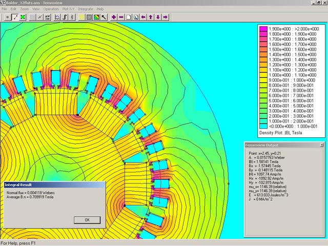

The air gap is significant. If you double the length of the magnetic circuit for a given magneto-motive force,the strength of the magnetic field is cut in half. (And the induced voltage will be cut in half). The lengths of the various components of the magnetic circuit are weighted according to magnetic permeability. Given that the ratio of the permeabilities of good magnetic iron versus air is in the order of over 10,000:1, you can often ignore the iron without serious errors. Just remember the saturation limit. Saturation of the steel is a limit but up to that limit the magnetic field strength and the open circuit voltage at a given speed are almost inversely proportional to the length of the air gap. What is next is some way to estimate the strength of the magnetic field relative to the saturation knee to determine whether it is worth while trying to shim the air gap. Possibly shims of magnetic material under the magnets.
If you are going to try to up the voltage the air gap is a good place to start.

Here's a view of the magnetic circuit, modeled with a 0.06" gap. My memory was incorrect: the actual gap is about 0.09"-0.10". In the model
results I arranged the output windows so that you can read them all in the image. The average flux per pole is 0.71 Tesla, or 1.5 Tesla in the teeth themselves, and there are peaks up to 2.0T in some areas. The model was drawn in FEMM, and I selected standard electrical iron for the stator.

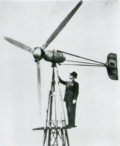

This thread got me to dig out an old book I purchased years ago titled 'Producing Your Own Power', edited by Carol Hupping Stoner (Copyright © 1974, Rodale Press). The first chapter covers Wind Power and in addition to ideas and plans for building your own wind turbines it also discussed some previously available commercial wind generators developed primarily for use on farms before the coming of rural electrification in this coutry. The two most commonly used and affordable models was the cheaper 'Stewart Warner Wind Charger':
http://www.vintagewindmillparts.com/phpBB3/viewtop...
and a more expensive and efficient unit, 'The Jacobs Windmill':
http://en.wikipedia.org/wiki/Jacobs_Wind
Anyway, I thought this would at least have some nostalgic value.

Thanks for the pictures, John. There are some old Jake's still running out there, as long as they get enough TLC. People can still fix them because the Jacobs patents are so detailed that they read like overhaul manuals! A farmer down the road from he has what looks like a Parris-Dunn turbine that's been in the parked position for 10 years. When I drive by, I'm always tempted to turn in and ask him about it.
