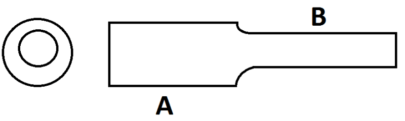

If I mount the following object on a V block at point A and put a indicator at point B, what am I measuring? Basically I want to see if the two diameter's center lines are collinear.

You are measuring circularity and coaxiality.

what if I trace up and down the smaller diameter? Is that runout?
RE: runout vs concentricity question
If you measure at one point at a time, it is Circular Runout. If you move the indicator longtitudinally while measuring, it is Total Runout. In total runout in this case, you measure circularity, coaxiality, straightness, taper, angularity.

I cannot see your picture (tinypic.com is blocked in my place), but you are always better off placing your datum feature in chuck/collet when measuring either runout or concentricity.
If your feature A is not perfectly round, using V-block to establish axis of rotation is a major pain.
Just an opinion. smile

If you leave the indicator in one position and rotate the part you are measuring circular runout. It is not possible to measure concentricity with a dial indicator. However, since runout will always be greater than concentricity it can be used as a quick check. If the runout is less than the concentricity requirement you are good.
Due note TheTick's statement about v-blocks. If your A feature has significant lobing it can effect the results.

Without touching the aspect of proper datum axis establishment by V-block at the moment, depending on how you will rotate and move the dial indicator or the part during the check, you may verify different things - circular runout, total runout or even ASME's concentricity. (dgallup, are you sure that it is not possible to measure concentricity [per ASME definition] with a dial indicator, of course assuming that datum axis is well established?)
What GD&T standard are you working to - ASME or ISO? Concentricity has different meaning in both, so it would be good to know what "Concentricity" means to you. Additionally, assuming you are in ASME world, "I want to see if the two diameter's center lines are collinear" makes me think that you are very close to mix Concentricity with Coaxiality.
