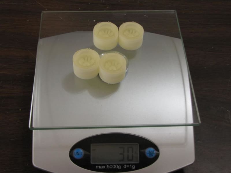

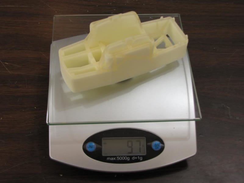

The parts in the printer.
Parts are encased in wax.
Here are the small parts.

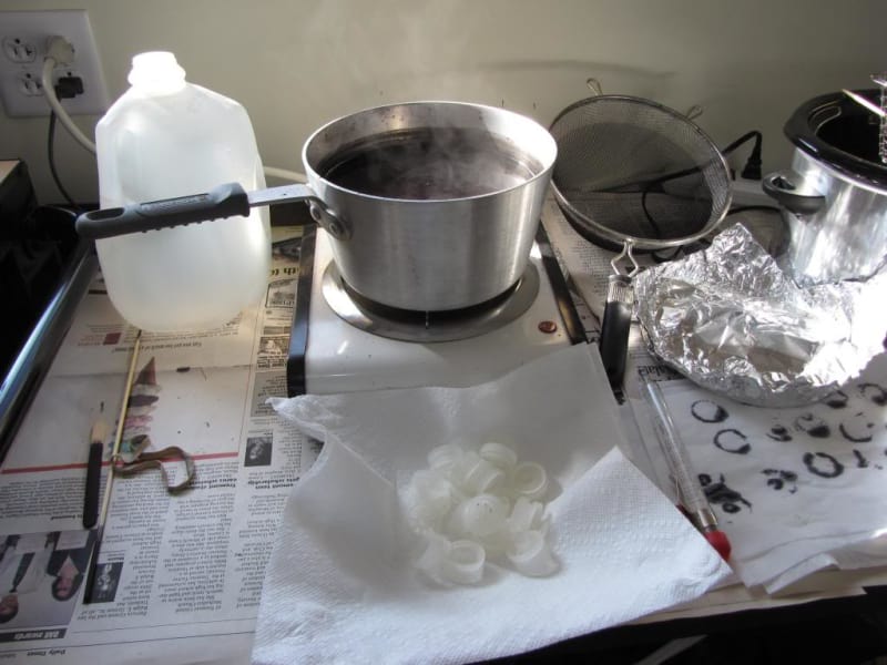

The dying bath, 5 minutes at 70c. The bath is about half gallon water and a full bottle of RIT dye.
After dying the first batch there is wax floating on the surface. It is impossible to remove the parts without the wax transferring to the surface of the parts. I have tried to skim it off with a paper towel, but it is very wasteful.
You can see the wax on the parts. Anything that is not flat black is wax.

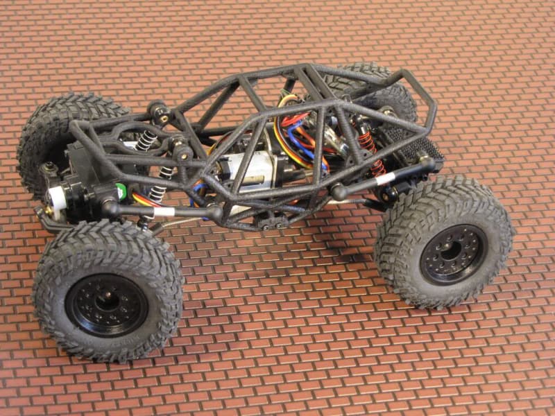

The finished product, but way too difficult...
