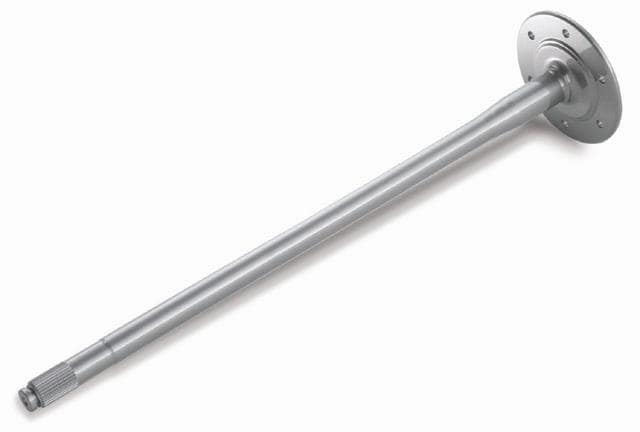

I am investigating solutions for my company on a weld that they have had failures with in the past occurring next to the weld. In the picture below it doesn't show any cracks but I highlighted where the incident occurs at.
I'd appreciate some suggestions as to ways to prevent this because on an up coming product, the crank will be experiencing much greater torque than the sample part I have shown in the picture and so we'd like to avoid this. My only thought was to either preheat the parts before welding or post heat treatment? Both seem like slow process's that would hold up the mass production of these parts.
I would like to bolt down the hub that the sprocket mounts to (the picture shows a pulley but this is for a different product) however because of the limited space that we have to work with, it seems like we have no choice but to weld it.

You have something rotating that will never be concentric combined with a weld configuration that is crappy in fatigue.
It's gonna break.

You didn't mention the type of base metal or the state of heat treatment. Was the material hot rolled, normalized, forged, or what?
You also failed to mention whether the failures were due to fatigue or if they twisted (torque) and sheared or if the failures were at the toe of the fillet or in the HAZ or in the unaffected base metal.

The welding process appears to be GMAW, which is usually considered to be a low hydrogen welding process. That being said, the welding process isn't the only source of hydrogen. The welding procedure should address cleaning to remove all hydrocarbons and cutting fluids, etc. which could be sources of diffusible hydrogen. The delayed cold cracks, i.e., underbead cracks, could easily take time to incubate. Once initiated, it could take more time to grow to a critical size. Right in the HAZ is where I would expect hydrogen assisted cracking to be located. Without sufficient preheat, the carbon content or the carbon equivalency could be considerably lower than the value you mentioned and still be susceptible to some undesirable microstructures.
I would expect fatigue cracks to initiate at the toe of the fillet weld. That is where the notch effect is the greatest and it is the location where you can expect to find minute oxides extending into the HAZ along the weld interface. While the shaft is rotating at relatively low rpm, it would not take long to accumulate 10 000 cycles, the point where a number of welding standards require the designer to consider fatigue. Small eccentricities or wobbles are all that is needed to initiate fatigue in the assembly.
One corrective step you could consider is to contour the weld after welding to produce a concave face and refuse the toes of the weld before contouring to melt out the oxides at the toe of the weld. Contouring would reduce the notch effect of the geometry at the toe of the fillet weld. Any undercut, regardless of how minute can be a significant stress riser when fatigue is a consideration.
I would also check the carbon equivalency to verify sufficient preheat is being used to prevent undesirable microstructures in the heat affected zone. I suggest you review Annex I of AWS D1.1 to determine the required preheat based on the chemistry of the shaft material.
You should also check the cleaning process used before the pulley is welded to the shaft. Cutting fluids used during machining or cutting operations are notorious for containing sulfur compounds and hydrocarbon. Both are bad actors when diffusible hydrogen is suspected of being a factor in weld failures.

What about eliminating the weld by using a forged shaft with an upset flange, similar to axle shafts, etc.? The sprocket on the other end could be joined to the shaft by splines, polygon shape, threaded fasteners, etc. Or possibly flip it around where the splines, etc. are on the pulley side.

Start at the beginning and request a lab to determine the crack mechanism. If it is at the weld toe (and corrosion is not a factor) then there are really only two possibilities for carbon steel: hydrogen cracking shortly after welding; or fatigue cracking after some time in service. These mechanisms are quite easy to differentiate. So your first important clue will be the answer to "where was the part when the crack was noticed and when?"
The RPM of the shaft is irrelevant; eventually the part will accumulate hundreds of thousands of cycles or more, it will just require more calendar time to do so. IF it turns out to be fatigue in the shaft, I will tell you in advance that making the fillet weld bigger will not help. Misalignment will be the primary driver for fatigue.
