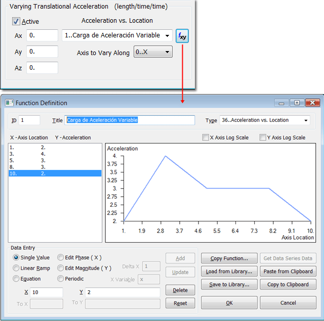

I'm studying micro flapping vehicles.
I need to evaluate the inertial forces due to the angular velocity of the wing during a cycle.
The angular velocity varies in strength and in direction
I found the way for setting on NX Nastran an angular velocity with varying strength but I did not find a way for setting
an angular velocity varying in direction too.
Does anybody have the solution?

Hello!,
Till I know NX NASTRAN only allows you to define variable static acceleration loads using ACCEL command, which may vary over a region of the structural model.

separate load cases, for each velocity direction ?

Hi, thank you for replying.
I tried to give separate load cases for each direction but I can do that only a static analisis,
The SOLUTION 601, which is the Advanced Nonlinear Transient, can analyze only one bodyload per time.
Anyother tip? appreciate it!
